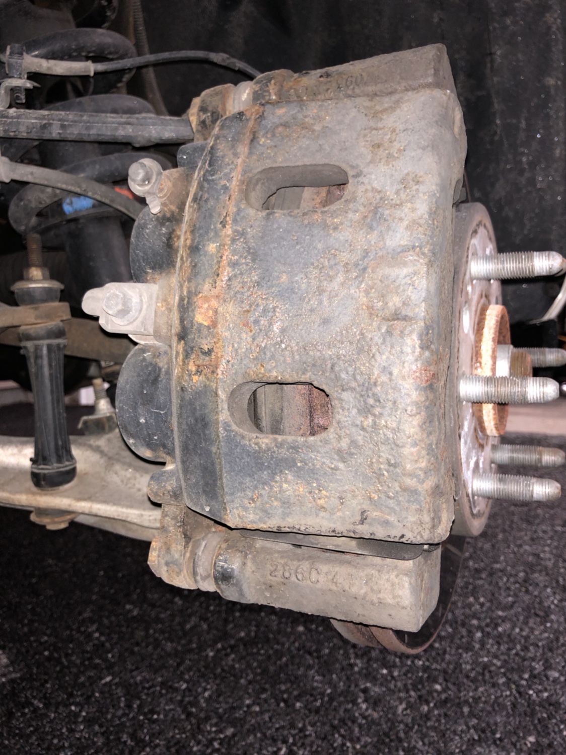

Couldn't tell you the difference in casting numbers. I figured it was either a change point in the manufacturing process (going from one brake design to another) or had something to do with specialty brakes (SSV/PPV maybe). My 07 SLT 4x4 had the 286C casting number. If you're looking for it, it's on the caliper bracket, not the caliper itself. I didn't even have to pull a wheel, my 20s gave enough room for a flash light and the old eyeball.

Thanks! Found mine as well, 286C, didn’t know where to look so I had to pull a wheel to find it, doesn’t help that they are covered in brake dust and corrosion.
For anyone looking its on the bottom of the caliper mounting bracket.
