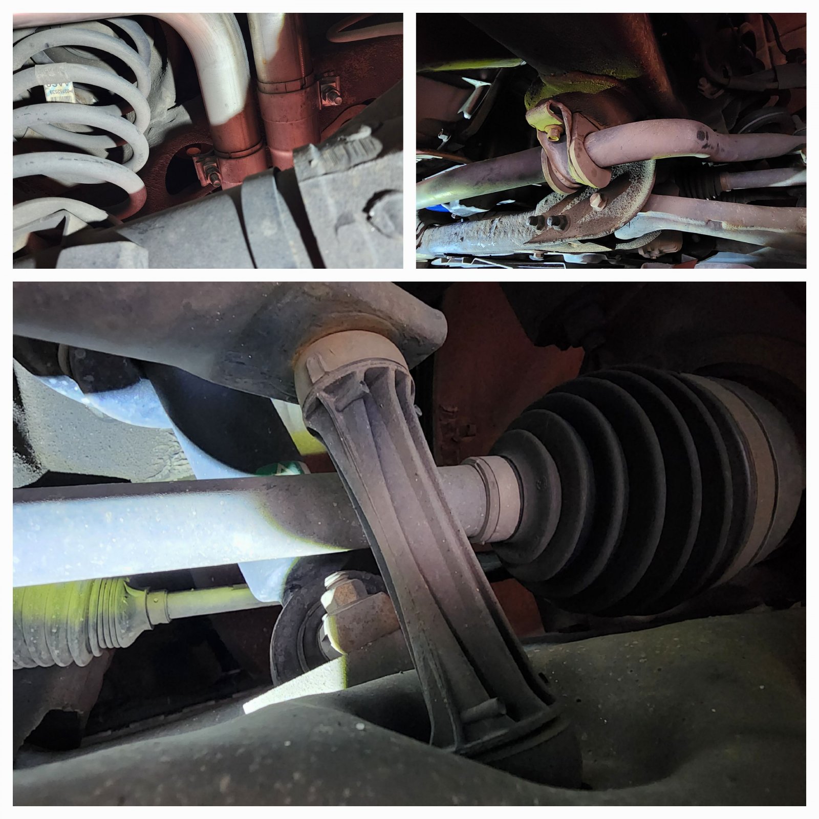

as already stated, the first thing that should be done here is determine "what has been done already" as there could be all kinds of different things going on.
I would get under it and take pictures and post them up here, then we can better assist you.
take pictures of both front corners wheels turned out so we can see the control arms and coils/shocks then from under it so we can see the sway bar and end links.
rear take pictures of the axle, springs/shocks and sway bar best way is under it from the center of the axle looking at the backside of the wheel area
this will tell us a lot
then scan the QR code on the door/pillar and or glove box and screen shot the rpo code list

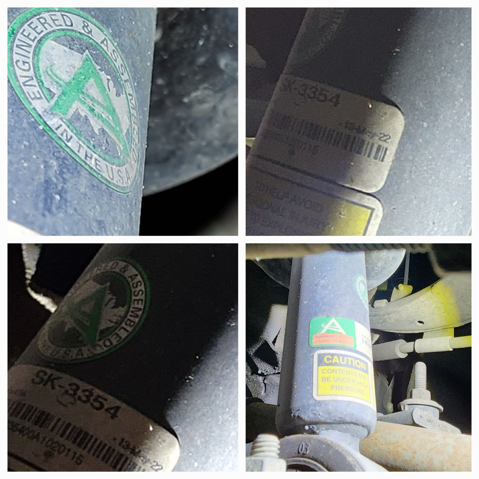

Discovered that the aftermarket setup is by Arnott. Manufactured in 2022 however I don't know when they were installed. SK-3354

I will get pictures of the control arms. What's the thought so far?

Arnott SK-3354 is aftermarket in a “non GM brand direct replacement” fashion and not a “performance” one. That particular model of Arnott is a PASSIVE replacement to the factory magnaride strut. This means it’s just a standard shock with a module on it to trick the vehicle’s computer into thinking a magnaride strut is connected and working so you don’t get error lights on the dash.
It’s the cheaper option at the dealer when the factory magnarides wear out. It essentially deletes that system. However, from what I read, they are a pretty decent quality strut.
What is on the rear?
