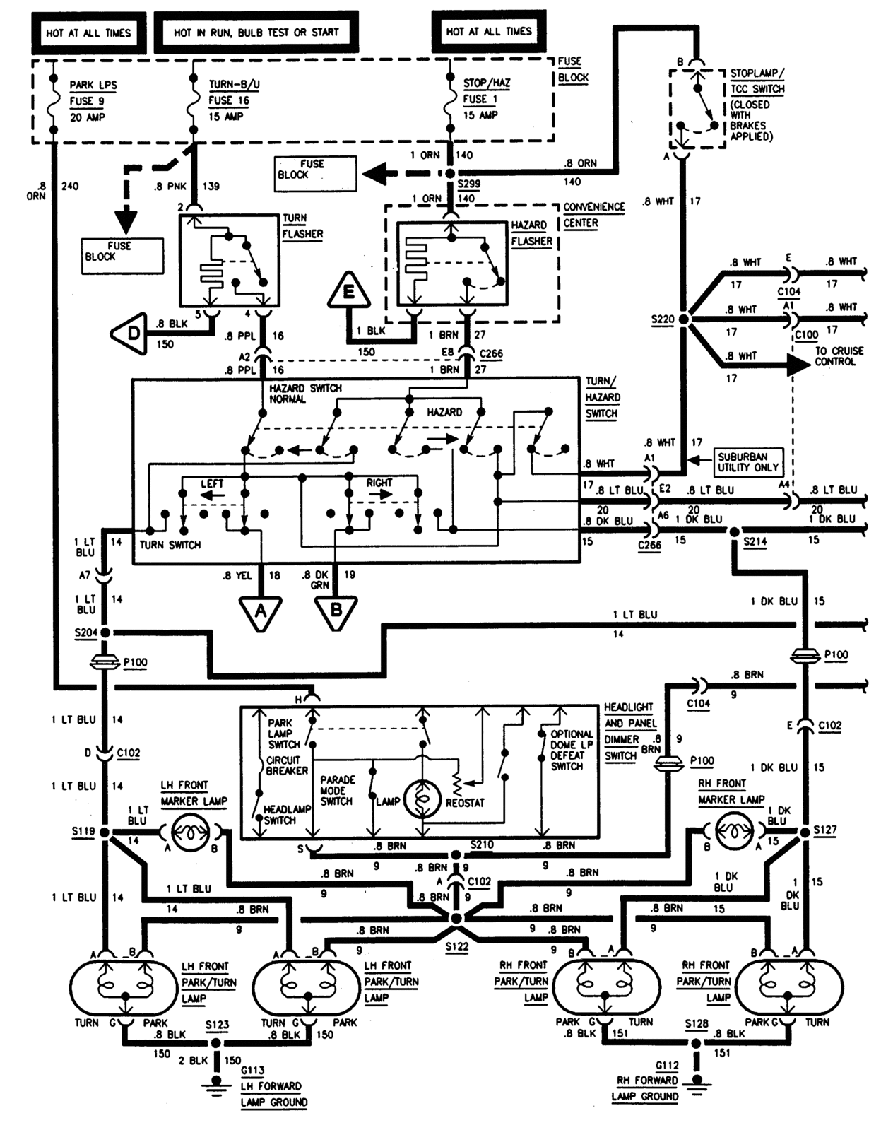

I have a 95 2Door and had the truck about 3 months. Here in the past 2 weeks the blinkers have stopped working. The only thing I can think of is I gave it a good detail a couple weeks ago and cleaned the inside and pressed down on the emergency flashers, which came on (no big deal). I didnt drive it for about a week later which is when I noticed the blinkers not working. The flashers of course are turned off. I know noticed that I cant push down on the emergency flashers either now. Do anyone know would this have something to do with the blinkers not working? And if so how do I fix? Thanks in advance.

Usually the combination switch fails. Also another quick and easy thing to check would be the turn signal relay

Power goes from the turn/bu fuse, through the turn signal flasher, through the turn signal switch, to the bulb. The hazard switch is powered by the stop/haz fuse also feeds into the turn signal switch which activates both sides. I do know that if the hazard switch is activated it "overrides" the turn signal switch to feed just left or just right, so I would say the not being able to push the hazard switch in is causing an issue, even if they are not on and flashing.
