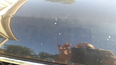

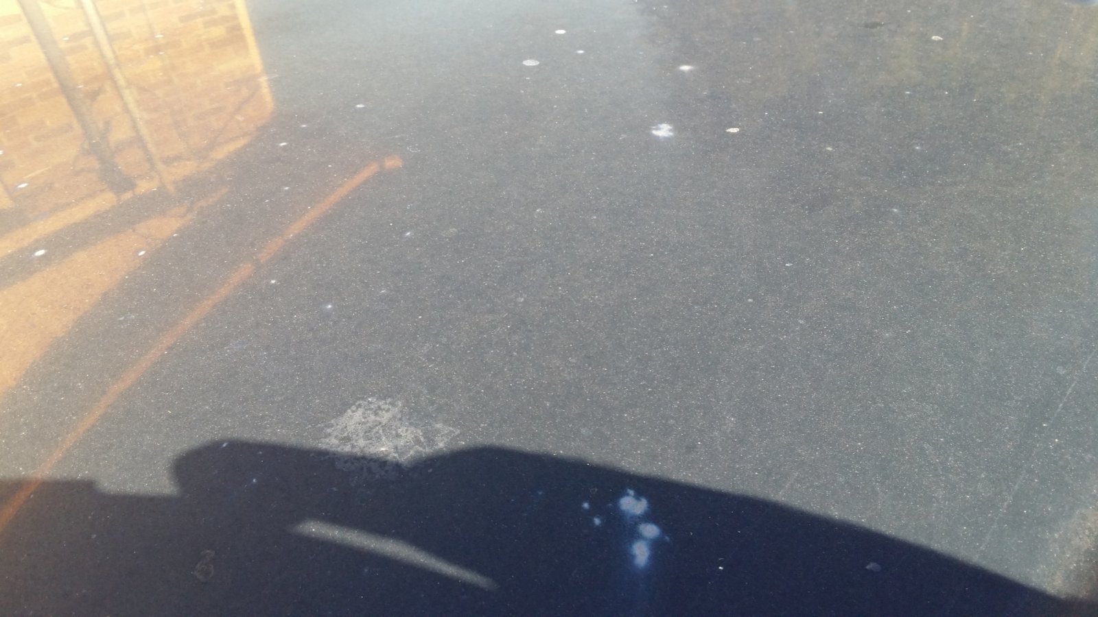

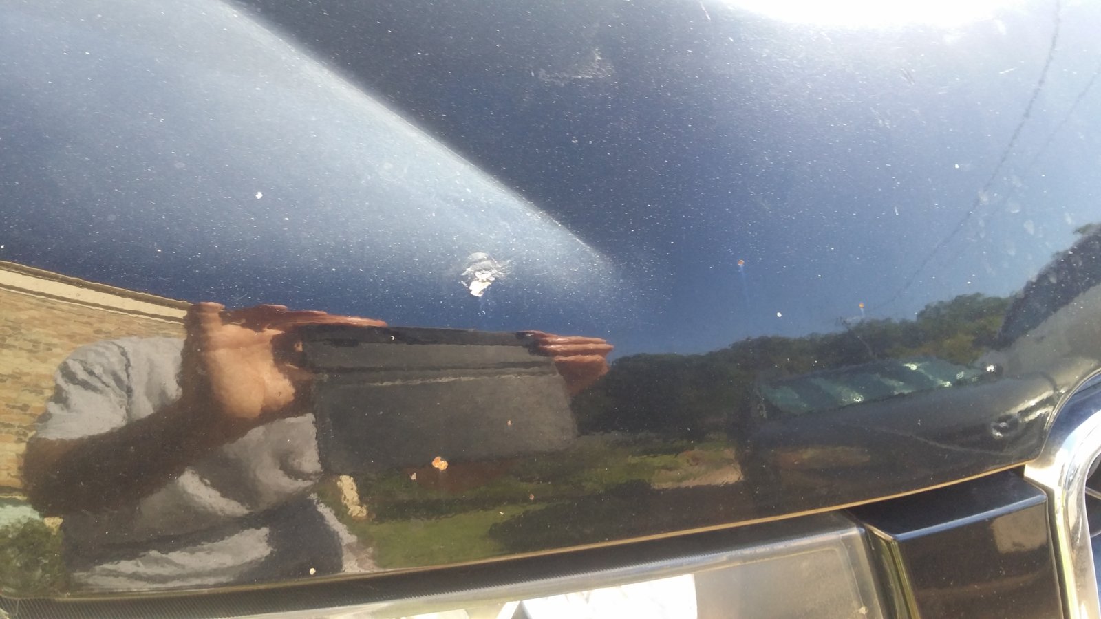

I noticed I have tons of rock chips on my hood and just recently noticed my roof is rusting as well. With a nice haze to my black paint which looks almost grey.

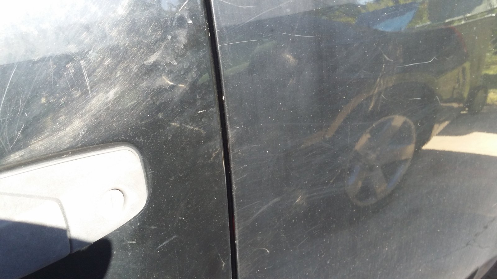

I'm ashamed it has gotten this far, actually its quite embarrassing.
Is it repairable? Is it possible to get it to shine again?
I think some serious paint correction is going to be need.

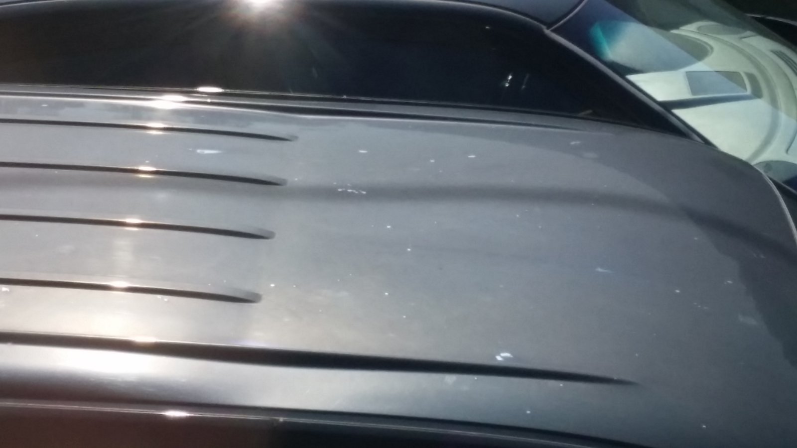

Last one of the roof from my kitchen.
The black cover that goes over the lift gate is pretty faded as well.
May just buy a new one to replace it.

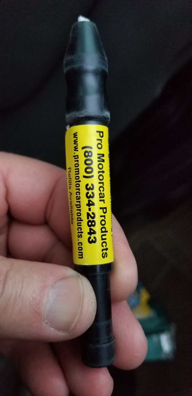

You def need one of these.
Works good for rock chips. It has a fiberglass tip that'll clean out the chip area/center, so you can fill it in with touch up.

You def need one of these.View attachment 203007 View attachment 203008
