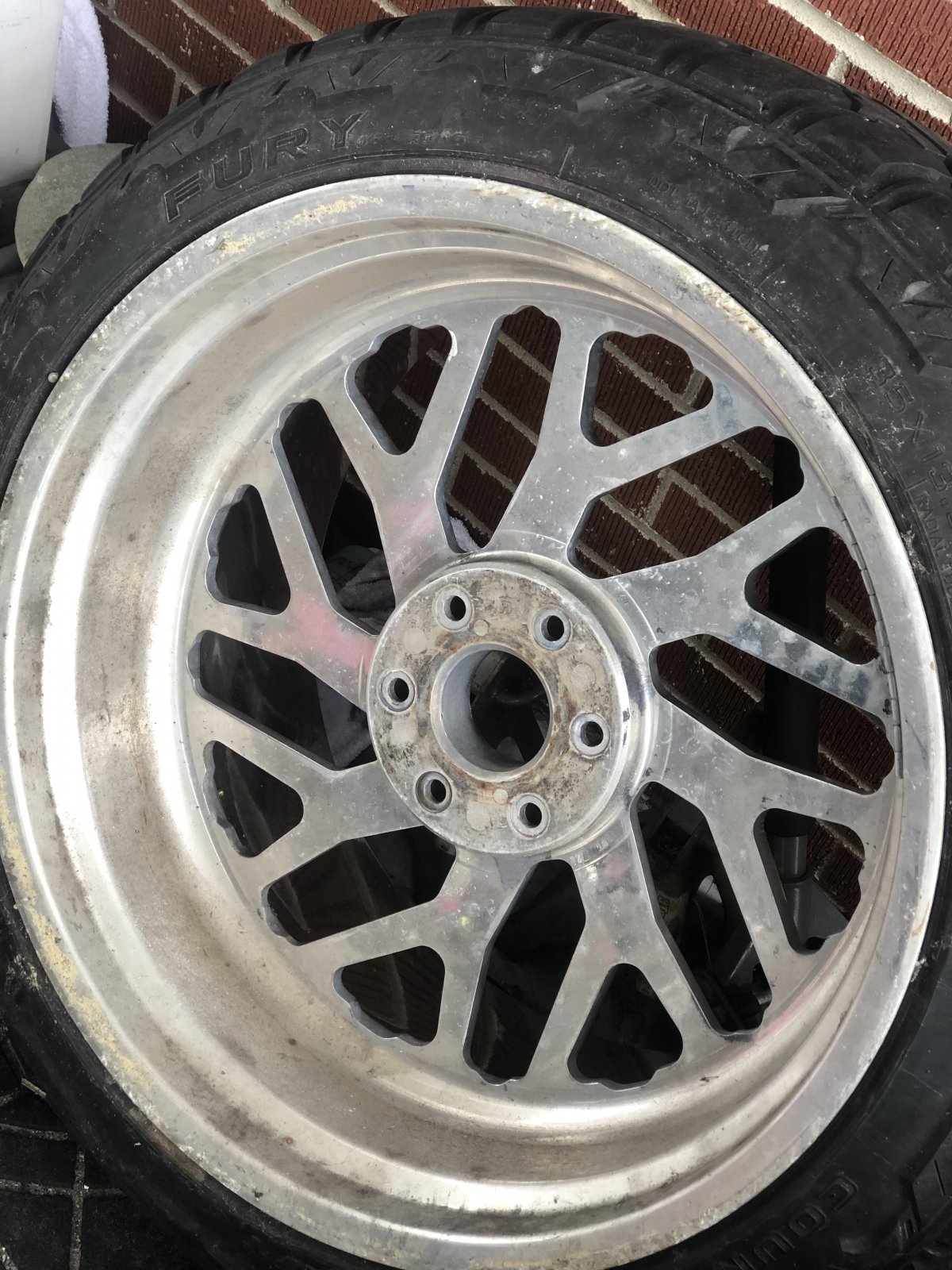

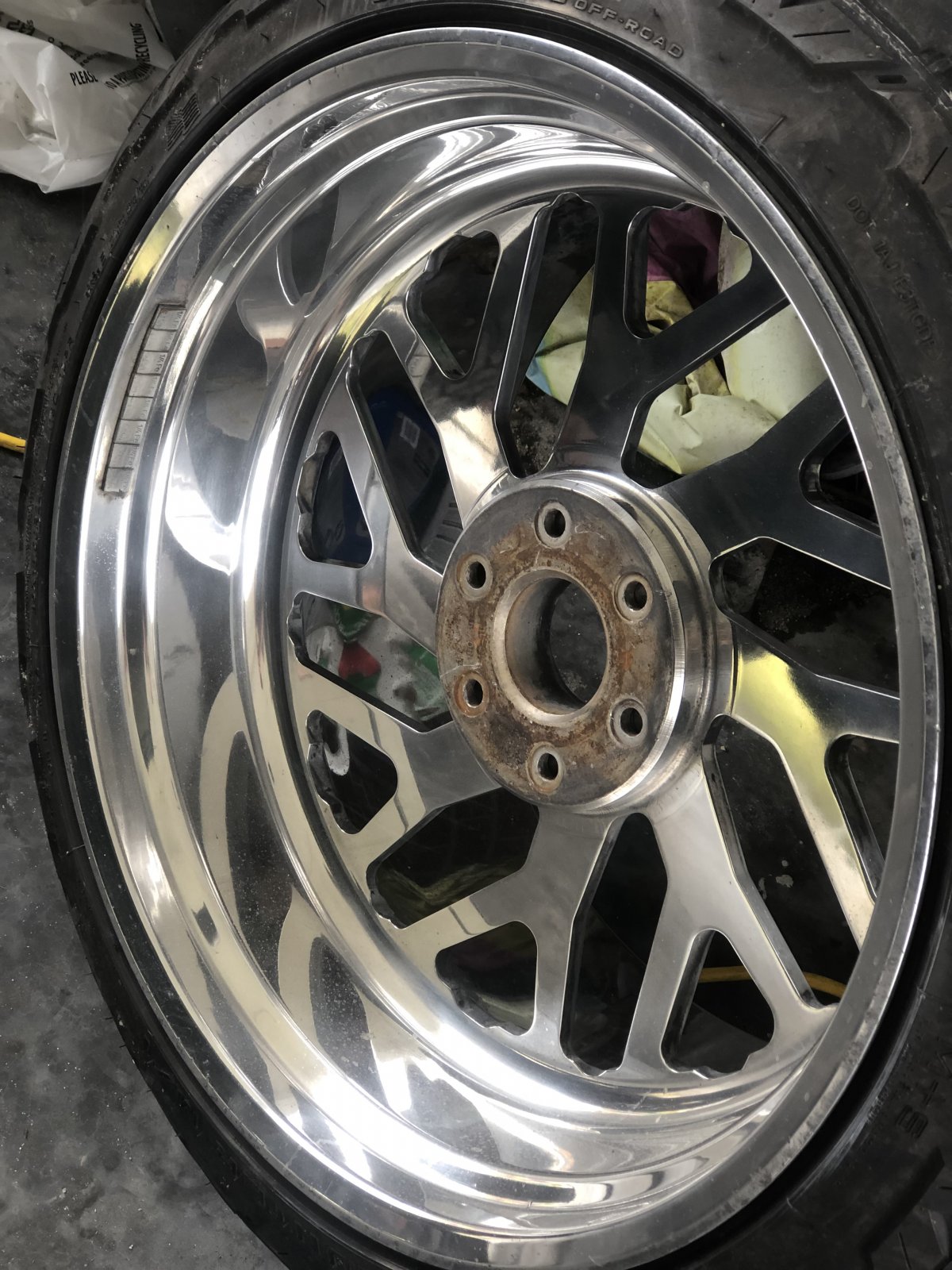

I’ve used all kinds of stuff and wasted all kinds of money at the end of the day cheap ol simple green is the best for the tires and brake dust/grease and does not effect the wheels finish and the polish is a company called zeyphrs YouTube them their polish is top notch the pics are just from simple green and the zeyphr pro40 hand polish and a buffer tip on a power drill the tips I scraped with a razor blade to get the rust pitting out and polished it back up

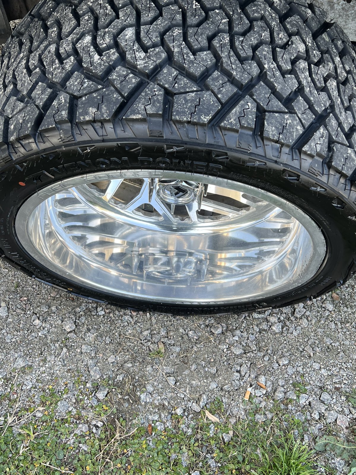

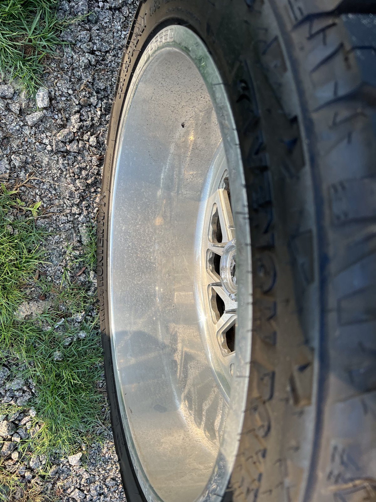

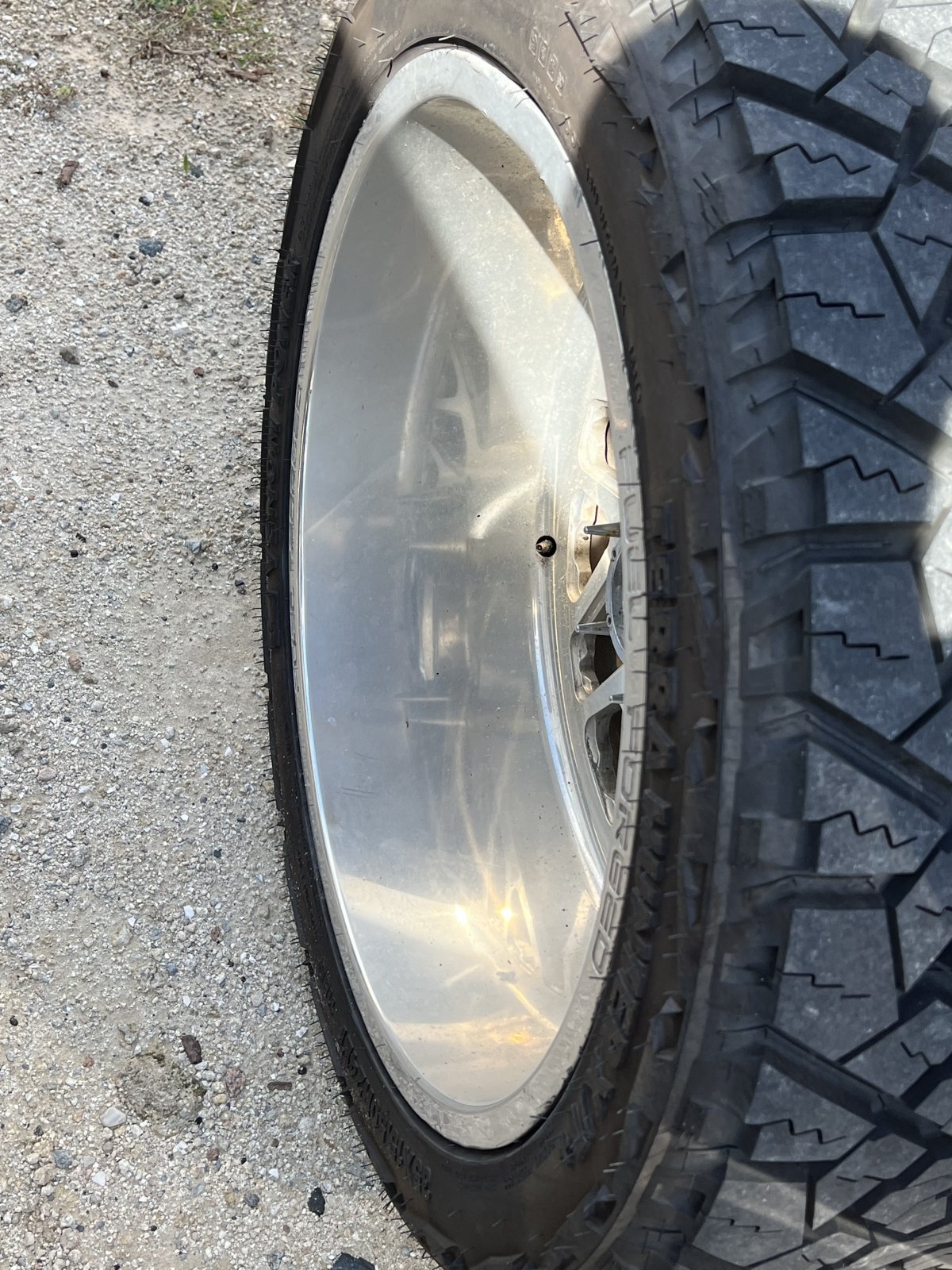

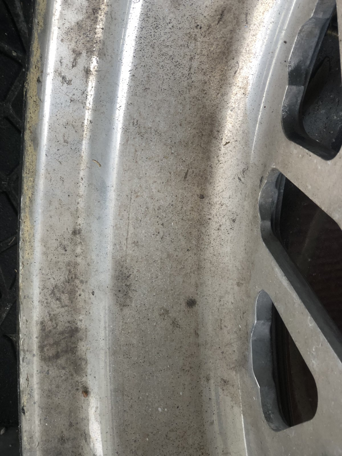

Better before and after pics this was using the supershine buffing kit on the big grinder no sanding just using the buffing wheels and compounds pics say it all this is good shit I’ve used it to restore pitted chrome on my uncles obs Chevy mirrors and bumpers also

WOW! Great results, gives me great hope for my 2013 Tahoe polished alum. rims.
Would you have a pic of the products?

The hand polish is zeyphrs pro 40 and the buffing kit was zeyphrs ultra shine polishing kit both were bought from 4 state trucks
