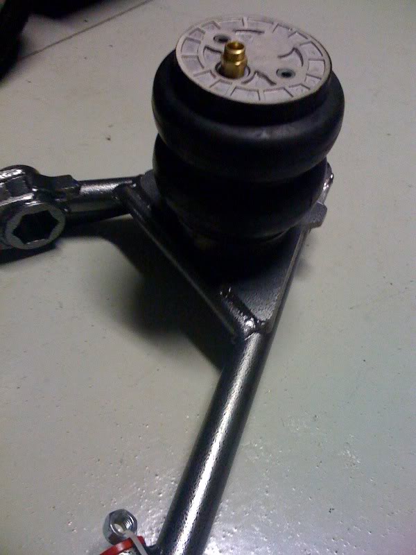

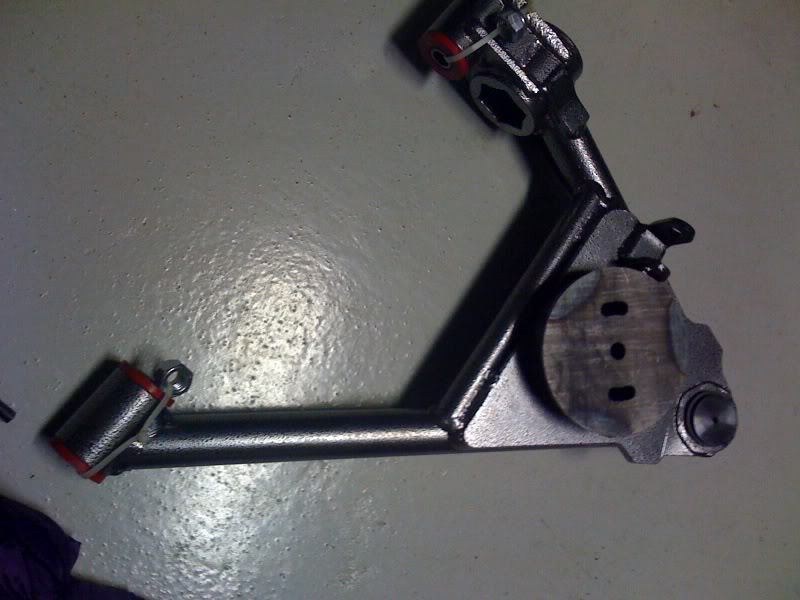

Has anyone run bags on the DJM lower control arms? Did you have to weld on a bigger plate to bolt the bag or just use the stock plate? Below are some pics of what I am wanting to accomplish (bagging it this weekend). I'll run the DJM lower control arm, with a small cup on the bottom and using a torsion style top mount.
Will this work using the DJM LCA's or should I put a bigger plate to give the lower bag mount more room? I'll remove the shock tab already on there, as I'll be running my shocks elsewhere.

look at my thread below youres. i think the last pic shows where i welded a plate to the top of the c/a to sit the bag. it works preatty well.
look at the end of the thread

Thats how we did mine... it even looks like the same bags.. i dont remember if we ran the 400 or 600psis but yea.. youre going down the exact same road i was.. and i could sit on the lower valence (the add on one like on the 06 and up) on 24s with 295/35s and get what im gonna guess was about 2 inches over stock..
