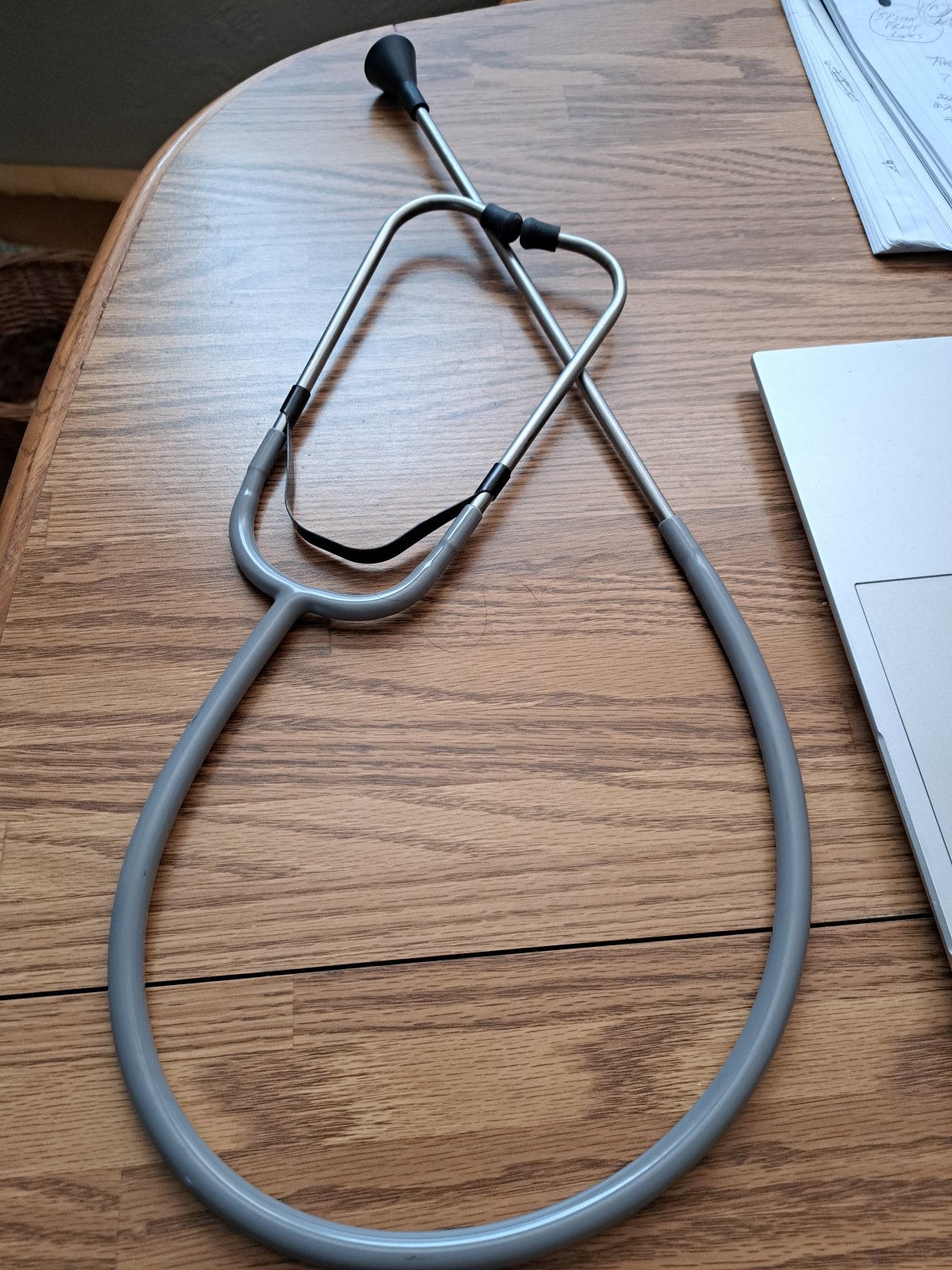

This is where a Mechanic's Stethoscope can be of help. Get one. They are not expensive. Crawl under and listen with stethoscope while a beefy friend jounces the left front. You can pin point source and maybe, just maybe, a squirt of silicone lube can take noise away, unless it needs a part replaced. I would be looking at control arm bushings and sway bar bushings, frame and links and anything rubber. Does it drive normal with no vibes or pull?

I appreciate your recommendation. I’m pretty sure I’ve seen a stethoscope in our shop at work. I’ll try to find it tomorrow and see if I can’t get one of the guys at work (or my 7 kids
) to bounce the Yukon around for me.
