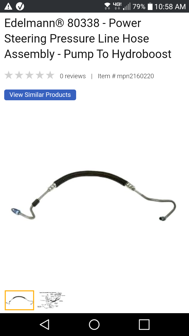

My 2007 Yukon XL has been having a bad power steering leak. I think we narrowed it down to this small hose. Does anyone know a part number/name etc and where I can order it? And how to replace it? Lol. It seems to be the one with the metal attachment going to it (from near the engine). Sorry, my photo editor isnt working so I cannot circle it . (AND I don't seem able to attach photos unless I currently take it with the phone right now)

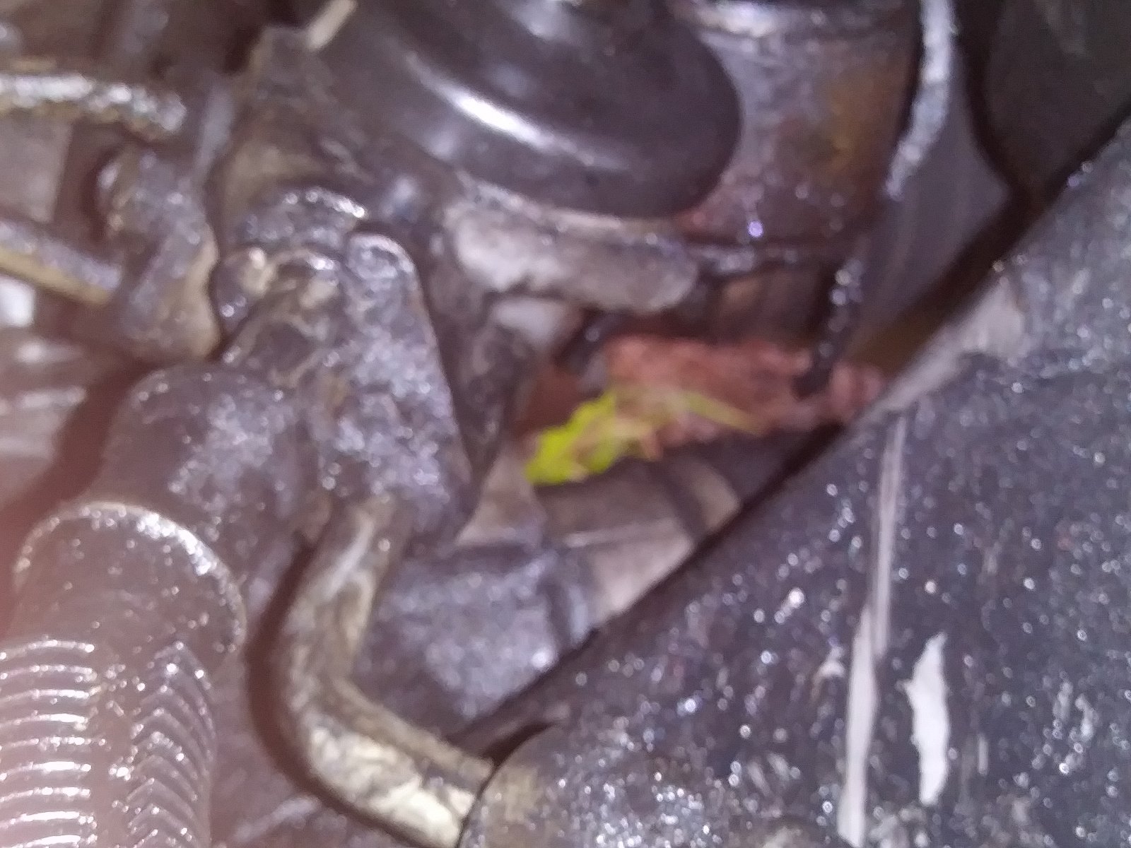

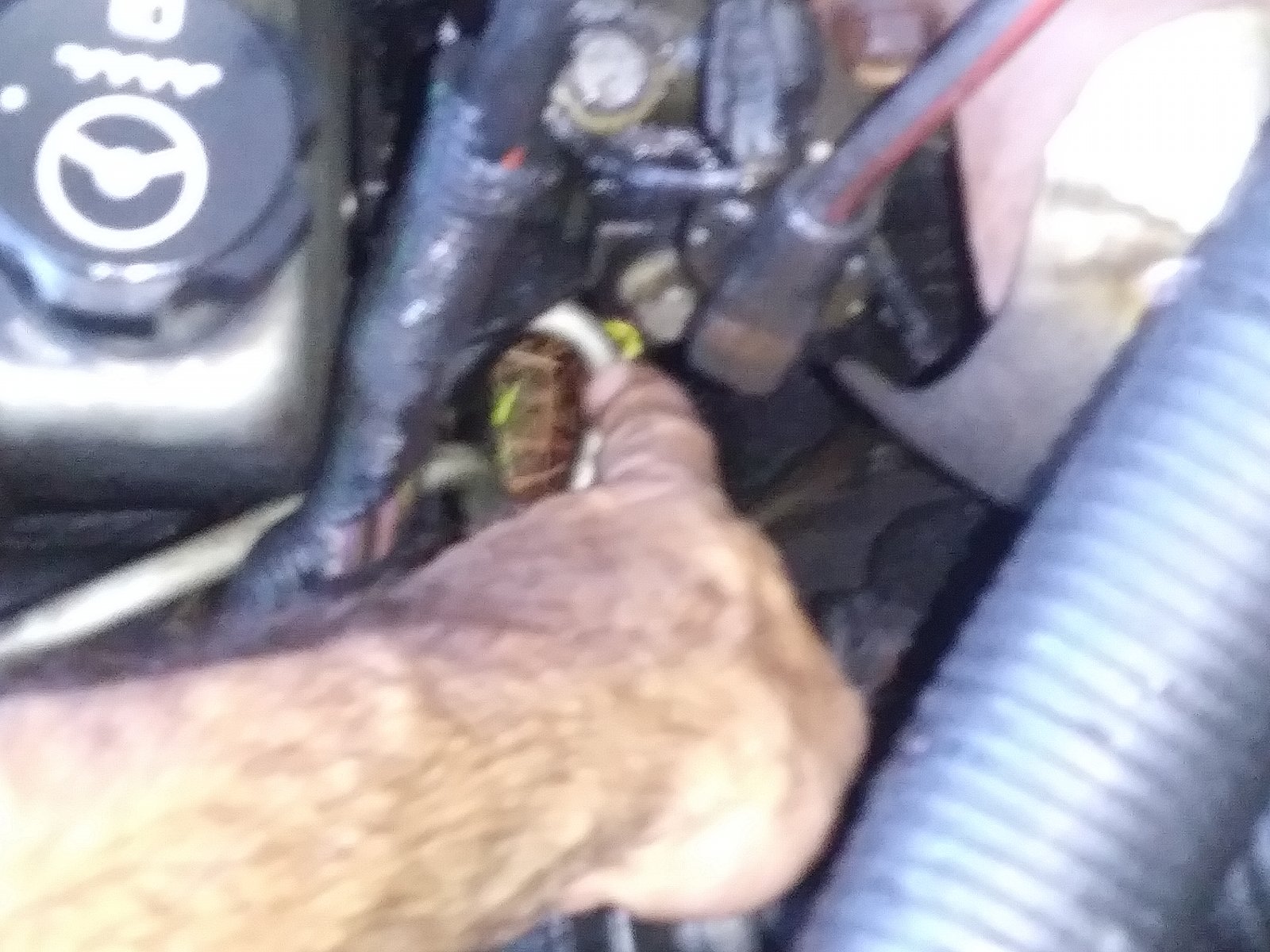

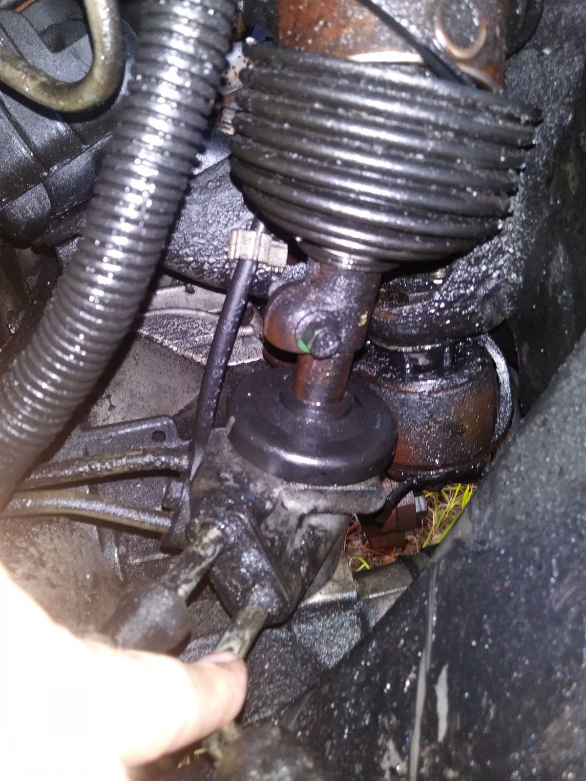

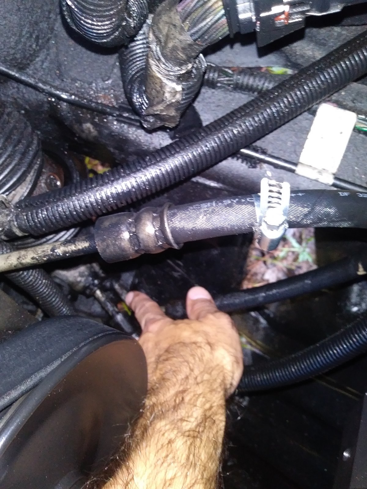

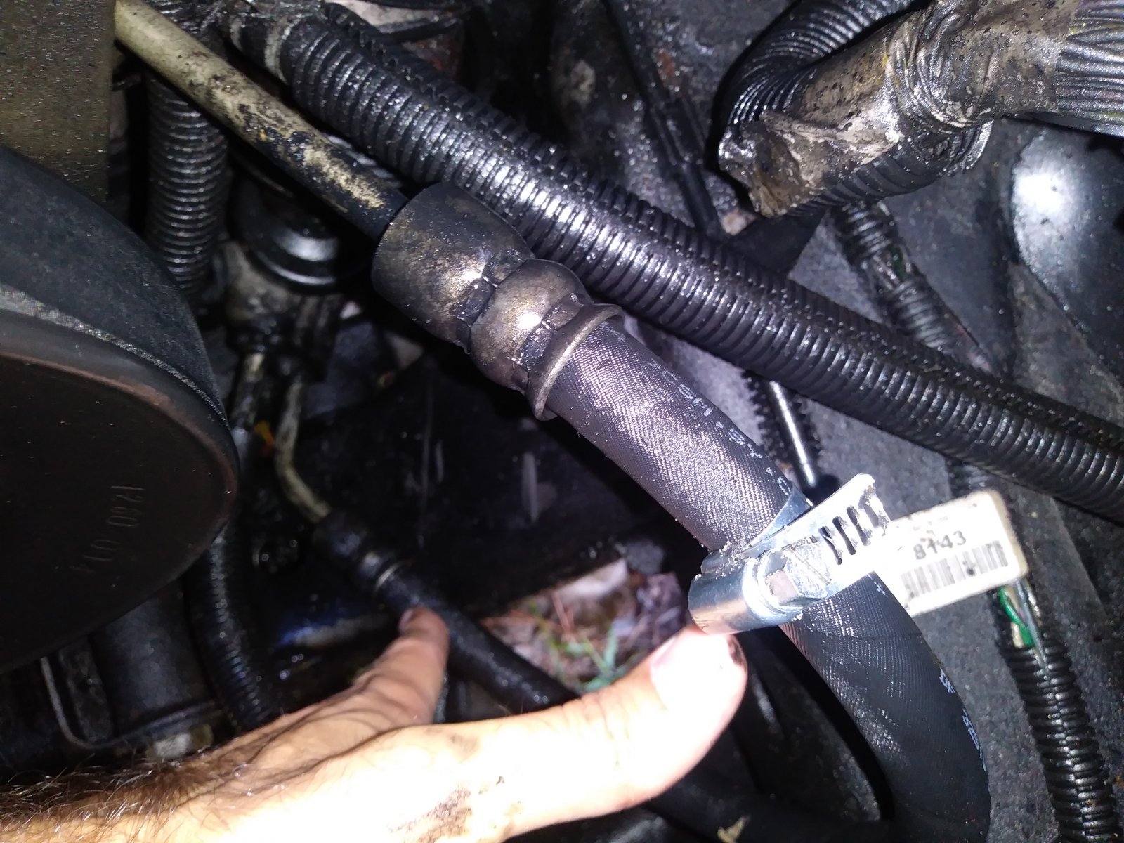

Sorry guys. Between my bad eyes, not being as experienced as you guys, and not being able to see and reach things ... I have more stupid questions....

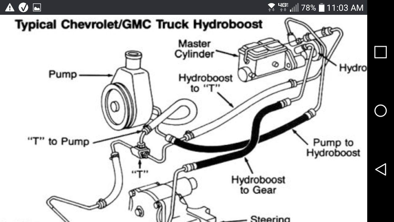

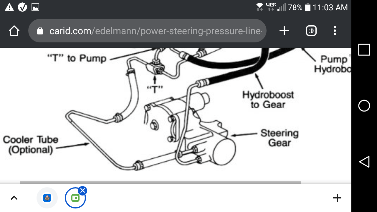

The one schematic shows what seems to be this hose going to the hydroboost which it doesn't.
I can most likely get the end off near where the power steering fluid cap is (I feel a nut behind it).
But the other end goes down to where I'm pointing at, towards the bottom of the car. Someone mentioned it looks like it is the top one, but it runs to the bottom / right one where I'm pointing at.... BUT I dont feel a nut . Do I need to jack the truck up and get under it and I will see it on the BACK of it or something ?
Sorry for all the stupid questions, it seems like an easy job , I. Just paranoid (and don't have access to a jack roght now. But I can probably park it on the concrete and crawl under. Thank you for all of the help

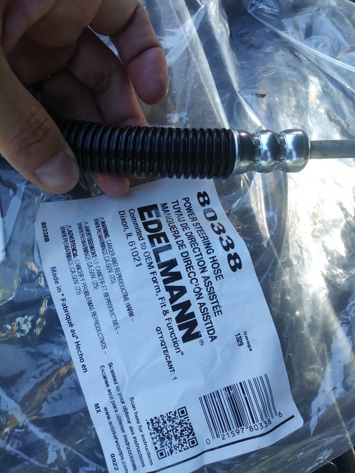

(And this is the correct hose? I was just concerned because the attaches hose is thick rubber and the new hose is that plastic-y ribbed hose)

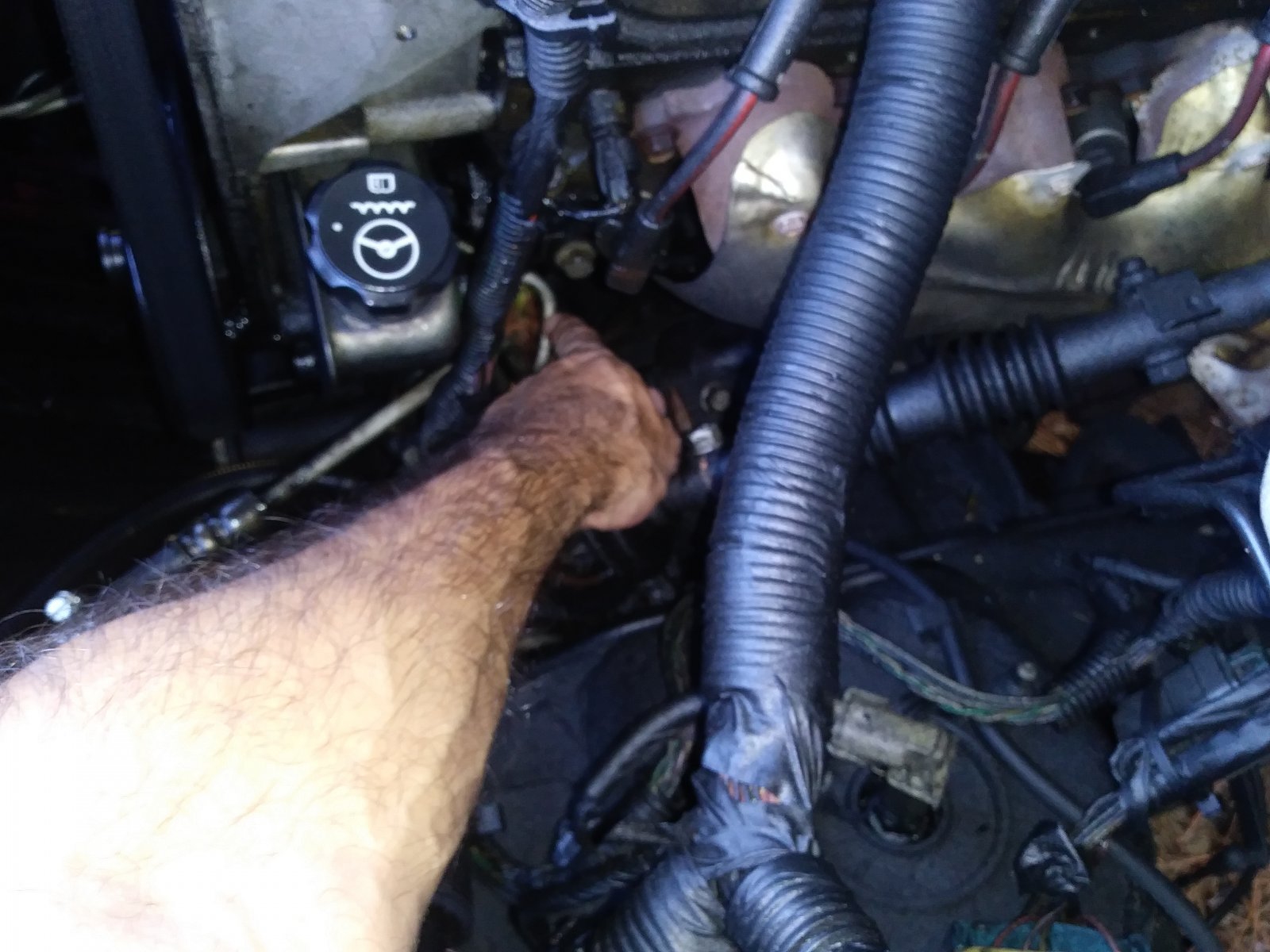

More

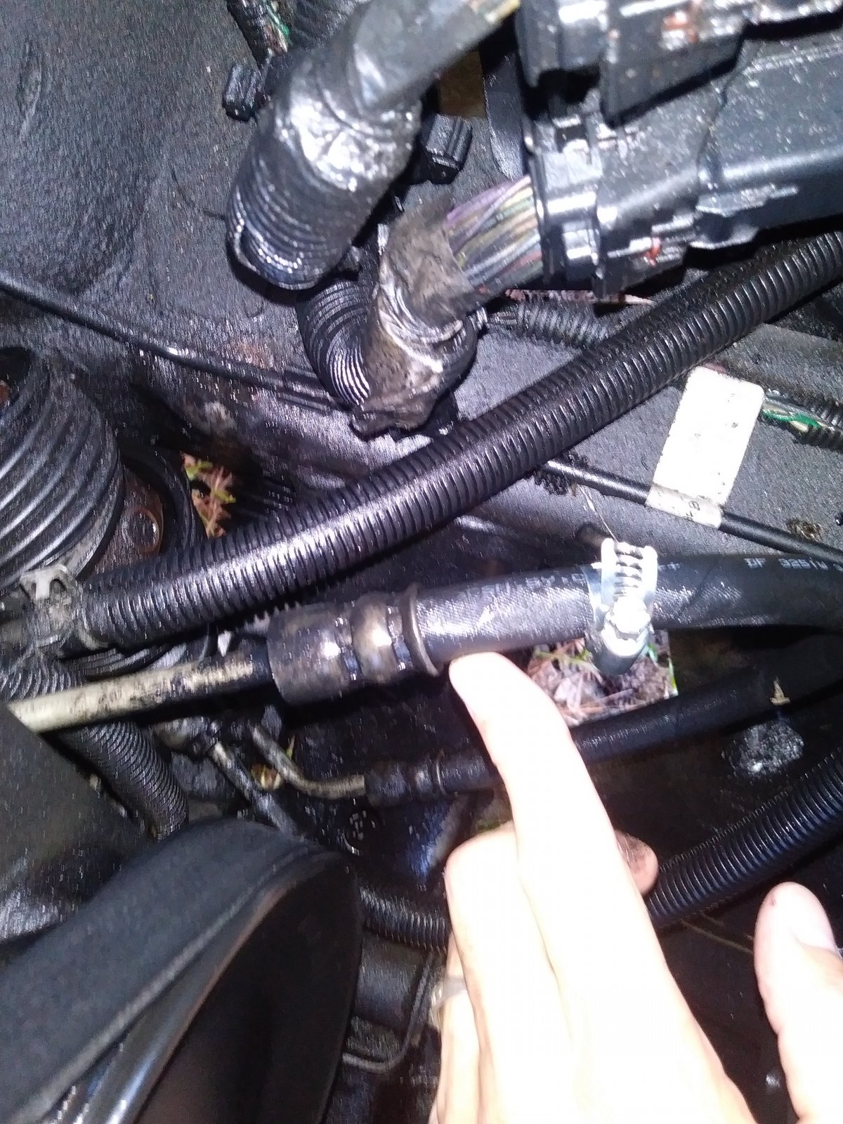

Where the clamp is, that's where it is currently leaking

This will fix you up. Did this job on my 2007 a few weeks ago.

I cannot fn do this and it seems so goddamn easy. I am frustrated beyond belief. The video shows great clearance from underneath. I crawl underneath and cannot see what to do with that upper part of the hose. Do I just undo that bolt in the middle and pull the whole unit out? I'm losing my mind. Sorry, I'm having a really bad day, week,month
