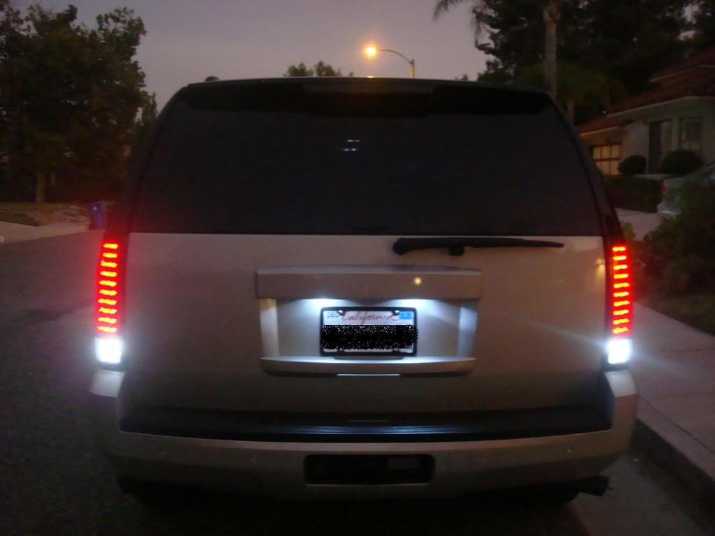

just plug them in and your set, ill try and take some pictures when it stops freakin raining...

They are just a 3157 LED bulb if I remember correctly. Cheap and very easy to find on eBay.
And they are plug and play. However, LED lights have poss/neg sides, so you might have to pull the buld out and flip it around to get it to light.
