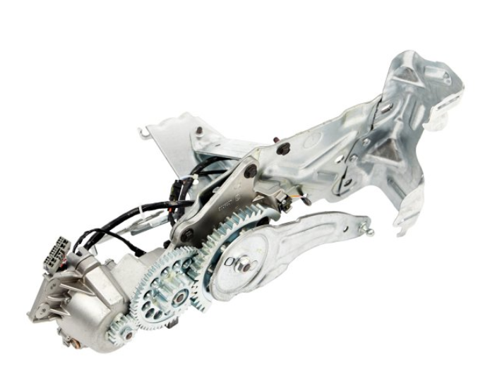

It could be a couple of things.
Your first post stated that you can hear the motor running but no action so that eliminates the possibility that your liftgate switch is turned off and it indicates that you are getting power to your motor, or so one would assume if you're hearing it.
The linkage could have come loose which you can try and check by grabbing the lift rod and seeing how much play you have.
I believe there is a clutch on the motor and those sometimes fail.
There are also a gear train that can strip out and if your gas springs failed, it could have overloaded the gear drive and stripped a gear.

Thanks for the info and the video! It looks like I may have the same problem that the guy had in the video. I guess I'll probably have to order a new latch so the gate can open on its own.
