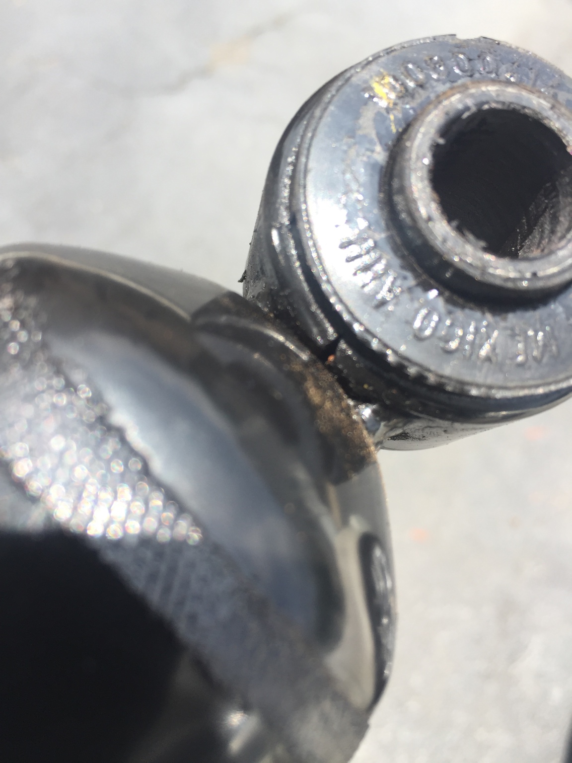

I had a bad experience with the "lifetime warranty" from Arnott. I ordered two rear and two front shocks, installed them and still had a leak. I found one of the rear shocks cracked (I'll include a picture). I called them and I was told that I can only return it if it wasn't installed on a vehicle which makes no sense to me because how would you know it was leaking if you didn't install it? I ended up ordering another one.
