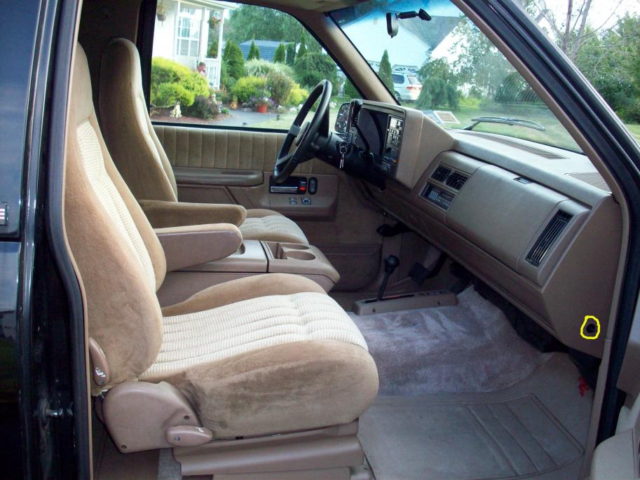

The door switches may be worn out. When I bought my truck both switches didn't work. If I wiggled the pin the light would come on. I replaced both switches and that fixed the problem. Does opening the tailgate or turning the dimmer switch all the way up cause the light to come on?

Turning the dimmer switch all the way turns all the lights on, however opening either door does nothing.
Where would one find the switches to replace them?

I attached a picture with the door switch circled in yellow. They're only like $6 each and really easy to replace. Just reach behind the dash and there are two clips on the switch that you need to compress and then just pull the switch out of the dash. I found it was easier to disconnect the switch after removing it from the dash.

Where can you get them, I knew which they were, (thanks for the pic anyways, super jealous of how 'clean' your interior looks, way nicer than mine atm)
