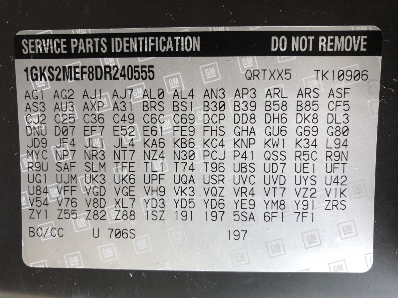

4l60e in the those have the same ratios. As far as rear axle there are different ratios. The two most common are 342 and 373. Usually anything with the towing package got the 373. This can be checked by the rpo code in the glove box. I forget what it is for those gt5 and gu4 I think but I'm sure one of the other guys here know those codes. Also tire and wheel size can have a big impact here because it essentially changes final gear ratio

I was gonna guess a 3.73 gear for the Suburban but if it is the 3/4 model could be the 4.10 gear depending on the package.
21,320
30,313
As mentioned earlier, check the RPO sheet in each glovebox and see what they have.

I dont believe that sheet is in my glove box.
Where else can i look to find this?
Sent from my SM-G975U using Tapatalk

It will be attached at the glove box door on the inside. I have even seen them at the glove box floor area where you have to remove all that is in the glove box to see the sheet. It will not be a loose piece of paper.
21,320
30,313
If missing you can send an email to GM with your VIN and they will send a reply with all of the codes and what they mean. Conversely, there's a company that let's you get 5 VIN checks for $5 but the name escapes me at the moment. Fellas, do you remember the one?
