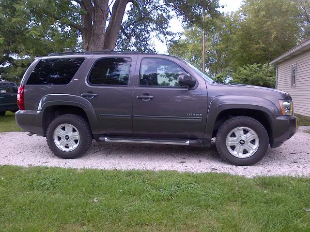

Well I went ahead and purchased the Top Gun Customz 2.5" level kit. Installation was very easy and only took 1 hour, although the directions are not 100% accurate as they use the same directions for 3 or 4 different sized NNBS lifts. Ride is ever so slightly firmer but nothing to worry about. Before and after measurements show exactly 2.5" of lift which puts my Tahoe at the same height ground to fender flare at the center of the wheel (38”). I like a little forward rake so I am going to install a 1-2” spacer in the rear. I am very happy with this setup so far. If anyone has a set of rear spacers that they want to sell let me know.

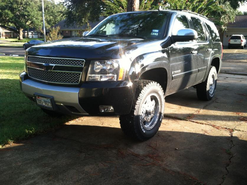

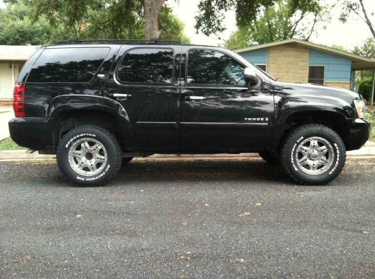

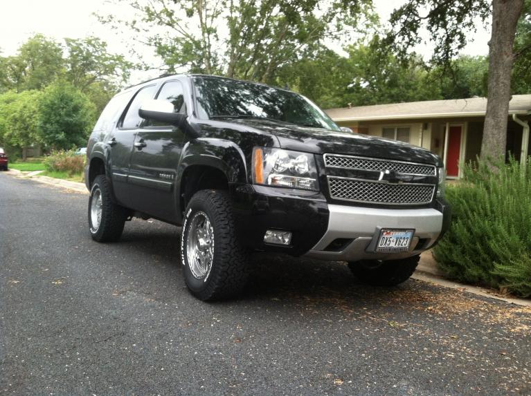

Looks good. Like you mentioned, I would get the rear spacer to bring it up in the rear. I think you need the rear about 1" higher than the front for the vehicle to appear level.

Nice tahoe, what tires and wheel backspacing are you running?
cjweb11
Sep 17, 2012
337
12
Houston TX
Cody,
Thanks Stoltz
The tires are BFG All Terrain 285/65/18
The wheels are 18"x8.5"
Backspacing is 4.5" (i think)
offset is -6mm (i think)
Wheels were on the truck when i bought it and have since been discontinued. Basically i know theyre 18" (duh) and i believe they only came in 8.5" width at that diameter. I have read they have 4.5" backspacing on a few threads/forums/etc in my research. So using the offset chart I determined a -6mm offset
That information could be wrong, haven't measured myself, perhaps something i will do after work today...
