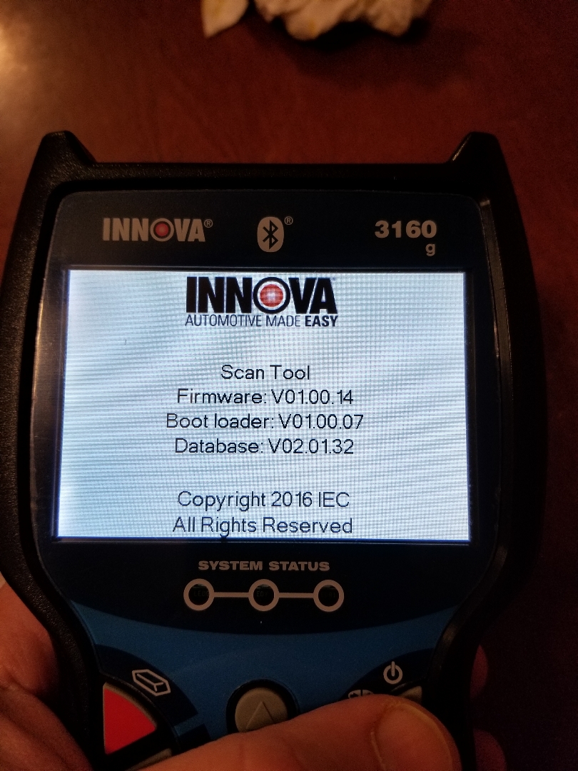

Ok. I ponied up the cash and got one.
Right off the bat? I checked the '06 Silverado that had the check engine light on for over 2 years.
Now this truck has had the engine, transmission and computer replaced at a Chevy garage.
Never shut that damned light off! I had a piece of tape over it for years now.
Hooked this Tool up, ran a few diagnostics that all came back good, so erased the stuff in the system.
NO MORE Check Engine light!
