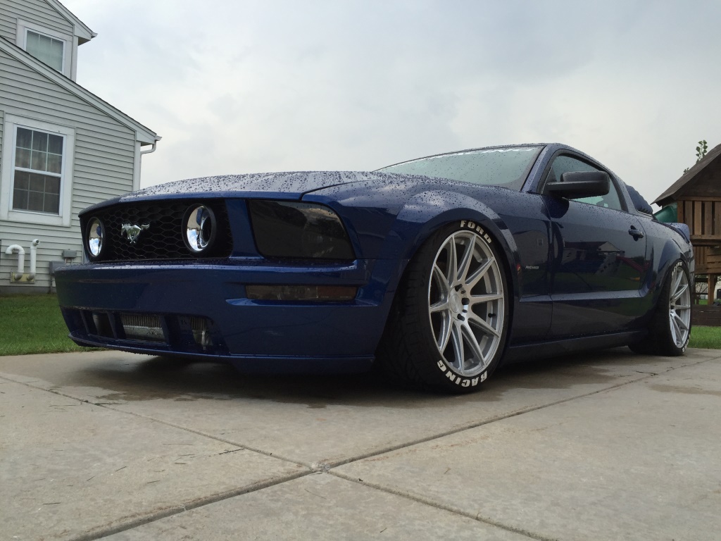

Could you go old school and get air shocks? Air shocks could be adjusted as needed, when towing just add more air pressure. On board controller with compressor. Like the Air-Lift suspension on my 06 Mustang. It is sitting low here but I can make it look like a 4x4 if I want too just by pushing a button.
