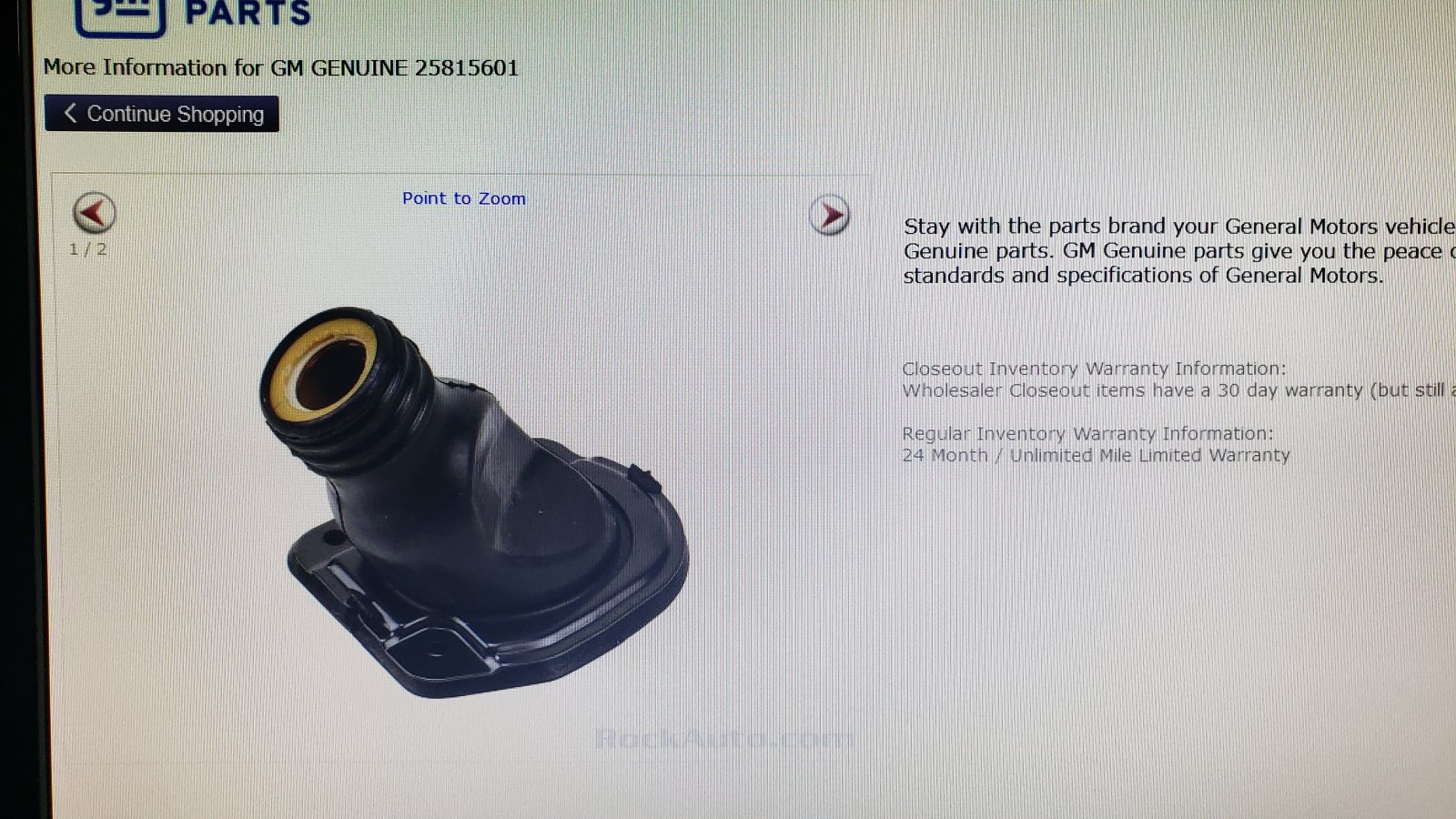

For a while now I've been having a very faint squishy/squeely sound from under the dash when I turn the wheel. Notice it more when I'm going slower like backing up into my driveway and the radio is turned down and I'm turning the wheel a lot. I've sprayed the steering shaft at this seal in the engine bay, and it used to quiet it down for a few days but doesn't anymore. Figured a replacement is $25, unless the sound is coming from somewhere else, but I don't know where or what else it could be.
Anyone done this? Hard? Easy? Tips?

I crawled under the dash and sprayed silicone spray liberally into the groove, then turned the steering a couple times back and forth all the way to spread the silicone oil into the grommet. It won't disappear completely but 90% of the rubbing noise will be gone.
wife's Buick has a tsb for a sound in the steering column, the seal.
There is a TSB for GMT900 vehicles too.
