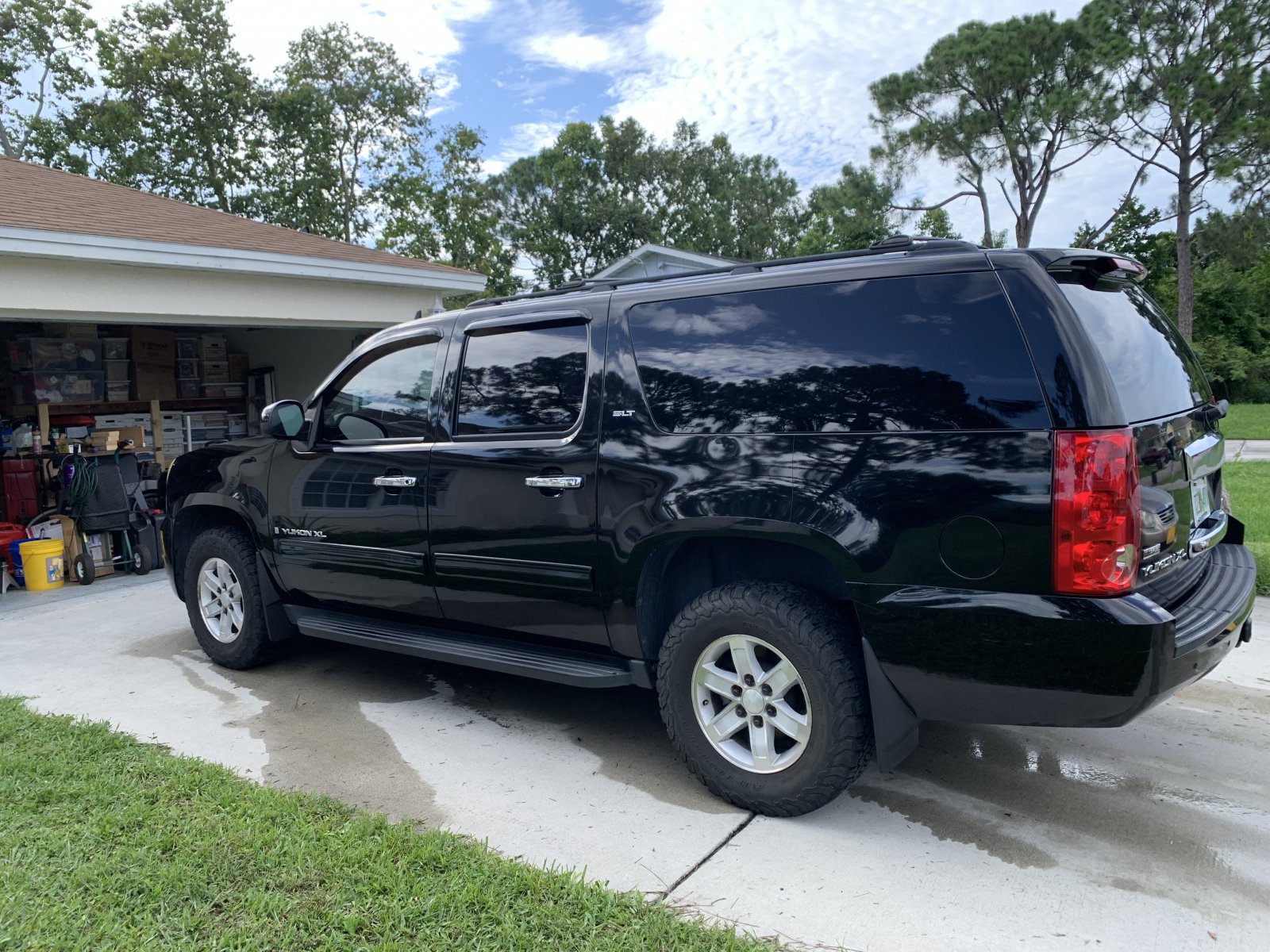

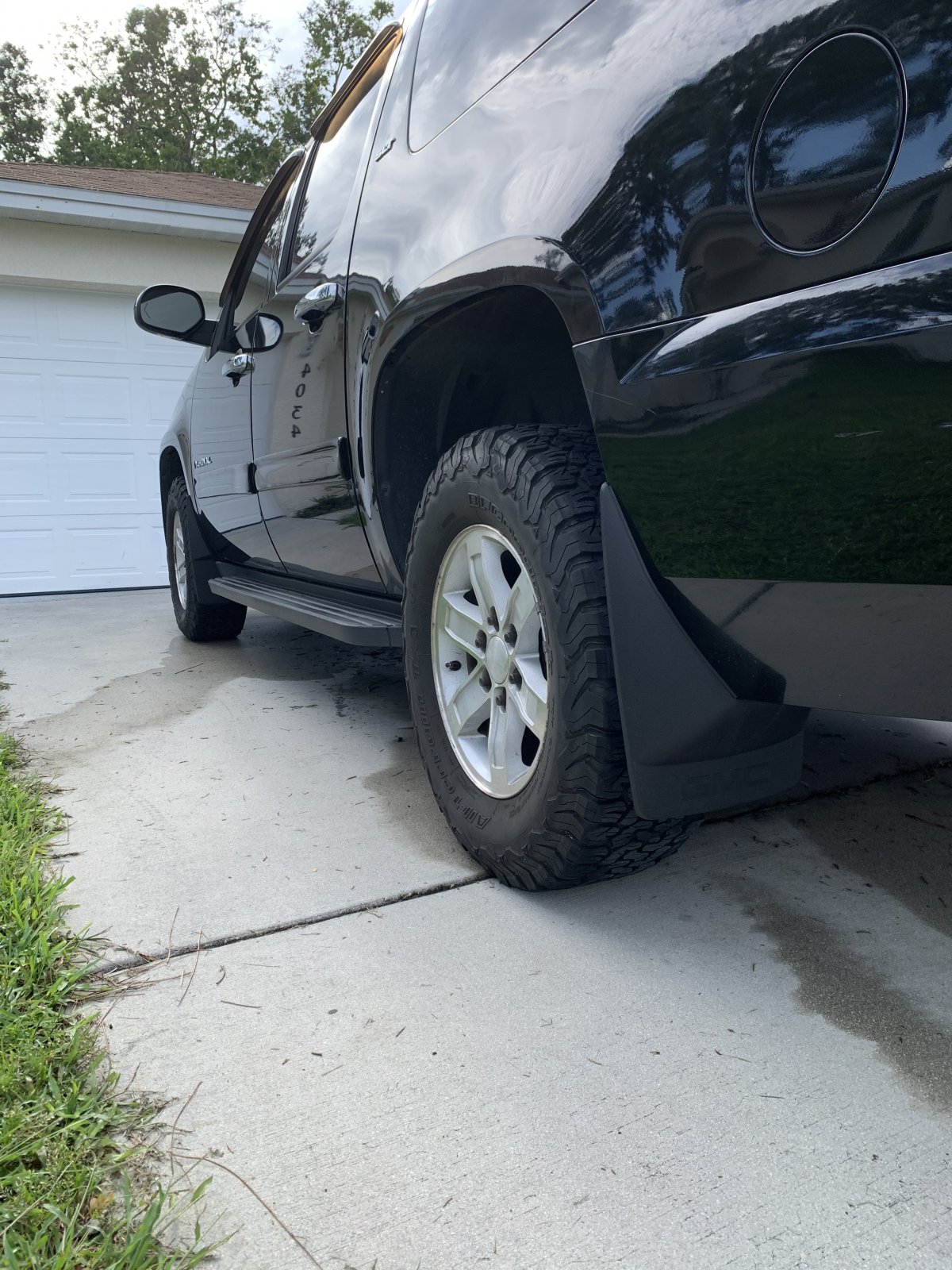

For my 2009 Yukon XL SLT, not a Denali, it has 19212819 front splash guards and 19212824 rear splash guards with the GMC logo. These were the latest design that had a piece of rubber between the splash guard and body of vehicle to protect the paint. I cannot say with certainty that the rears will fit a Yukon Denali but provided photos for you to decide. GMPartsDirect doesn't seem to distinguish between body lengths or trim levels. I do know that they don't fit powered running boards.
A few years later I did this project again with my 2013 pickup. Had to buy several sets off of Ebay to get the right ones. At least they were inexpensive.
They've been on the truck now for almost 5 years and are holding up great. No more sand or standing water on my running boards.
GM also made these painted with the body color. Mine match the running boards.

Thanks for the help! Yours look exactly like the ones on my SLT and are what he is looking for. I bought him what look to be the same rears but they are part number 17802160 which GM says was replaced by 19212822 but you have a different part number yet lol. I assume the wheelbase doesn't matter because the shapes are the same but it is GM we are talking about here.
I looked up your front number and they are discontinued and also show a different shape than what you have. This is all really confusing and I am about to just get him Huskys or Weathertech and call it a day lol.

I feel for ya, went through the same thing for two of my trucks. Some of the part numbers are for painted. Some are for flat and you can paint them, some are for pebbled, some have GMC or Chevrolet logo and some of those have colored logos!
I didn't like the aftermarket ones at all and so I made the effort to discover which was correct.
Ok, so on those two part numbers you posted, they are all valid. They even check out as working for a Yukon Denali on GMPartsGiant. Like I said earlier, the last design had that piece of rubber to protect the paint. There is a grainy picture of 19212822 and it looks to have it too. Part numbers could change because of a design change but more often than not, a vendor change.
