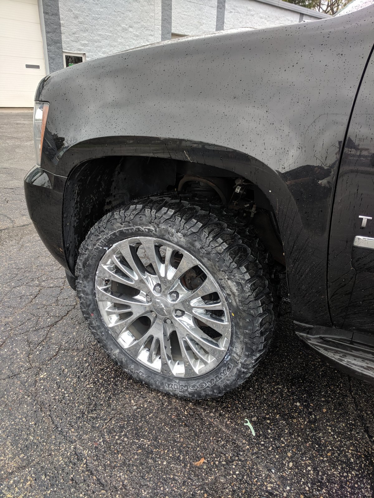

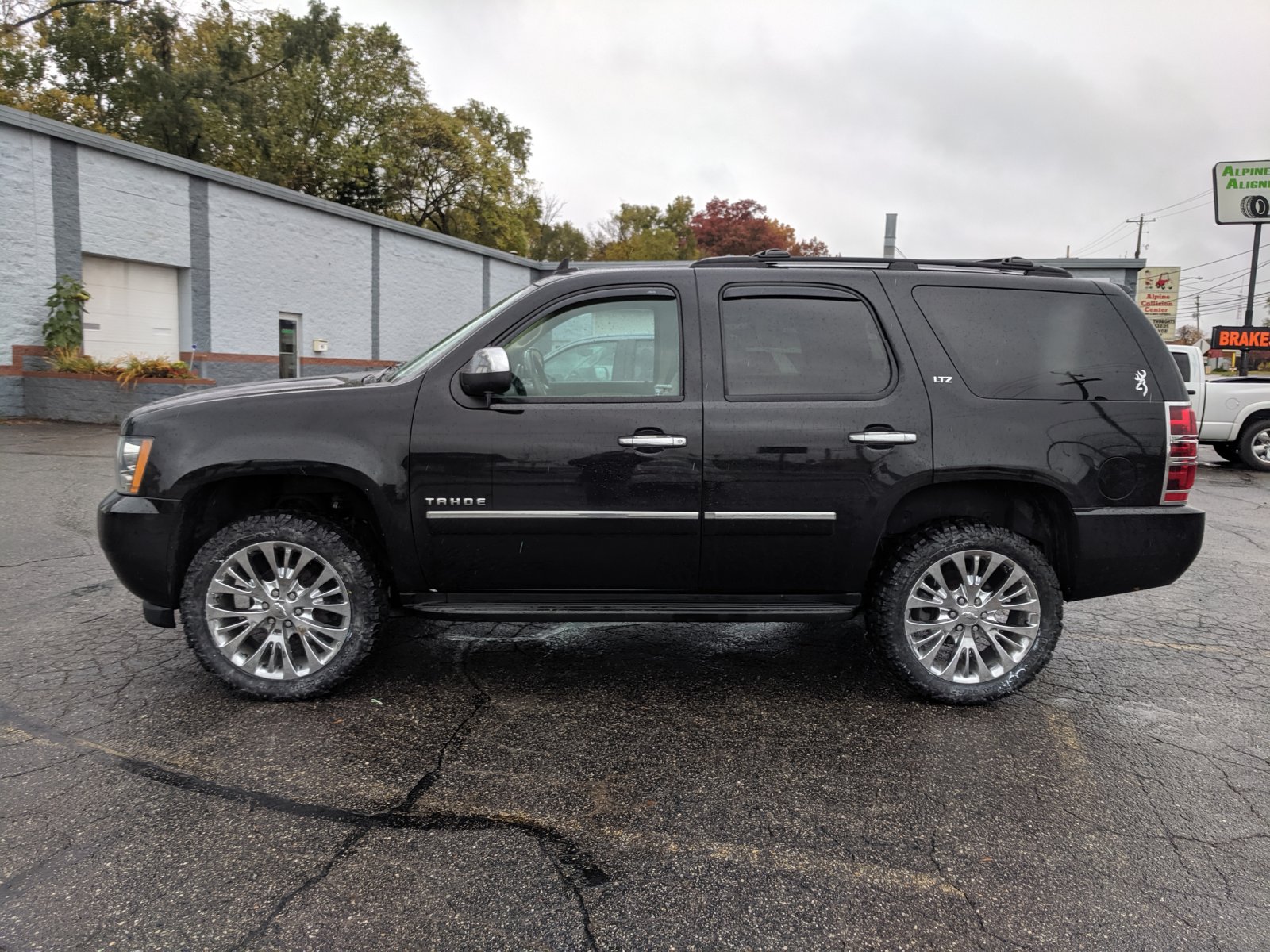

I have 33/12.5/22 tires on my 2013 LTZ Tahoe with 2.5" front and 1.5" rear lift. I had to do some front inner fender trimming.
