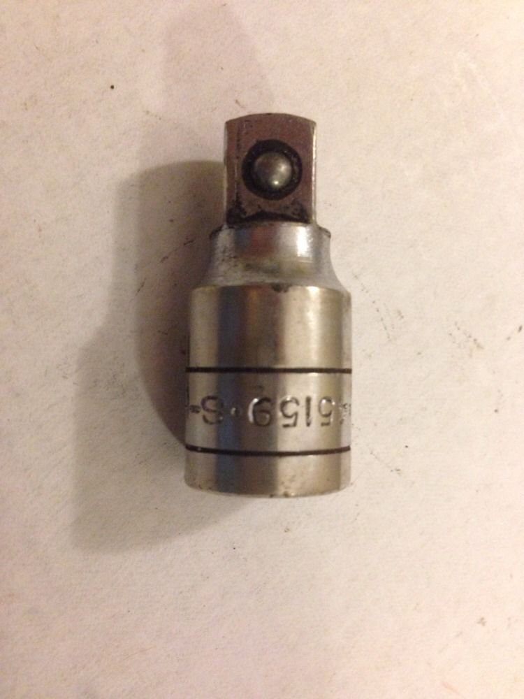

There's an easier way. Normal 5/8" spark plug socket and an SK 1" extension. Part # 45159. Ive had mine since my Camaro days but it's still available from SK. They call it a 1.5" extension now for some reason. It didn't take me any longer really to get the #8 plug out than any other. Hardest part was getting the plug wire boot off of it. Saw this one on ebay for $4.00

I looked online for tips/tricks to do #8. 1" extension was the trick. I couldn't find one at any local parts store so I made one.

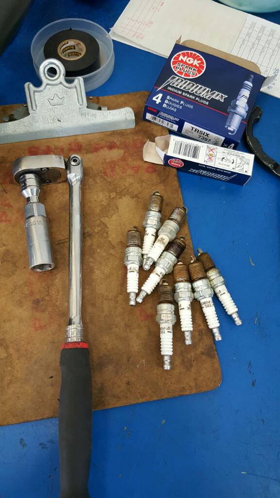

Seriously with all the fender liner pulling? I just use a 1" extension and a short spark plug socket on a swivel head ratchet. Easy peasy after pulling the wire off. That's the only PITA i encountered.
