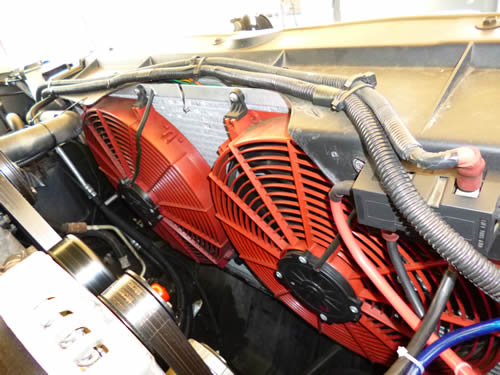

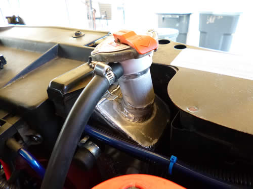

I used the aluminum one off of ebay and I love it. It's big and all metal. IMO all radiatiors with plastic tanks suck. Don't forget to convert to EL fans! The 40" will fit 2 16" fans side by side. Also a pic of the welds on the aluminum rad

You should have gone with electric fans instead of the old clutch fans changed mine about two weeks ago and love them.
