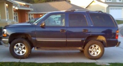

Done for now, 3" spindle 2" spacer and 285's
Thanks for all your help, will go 35's later, couldnt pass up the deal on the 285's and Sierra wheels
