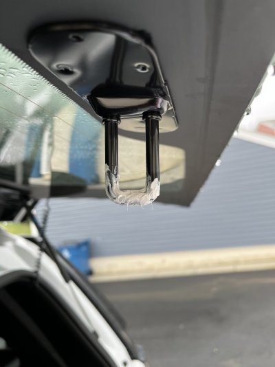

I also had a squeaking sound coming from my tailgate whenever I lifted it. Since I have the SLE model, it's a non-power tailgate and the noise was probably more noticeable than one with the power motor. After looking it over for a bit, I was able to pin-point it to the exact same spot B520044 found. A large glob of grease on the striker/latch pawl and the creaking/squeak noise is gone.

I had the exact same issue and fixed it myself with the fix posted above. Here’s pics of the latch. There is also. TSB from Chevy (# PIT5768 I believe). I tried to get my dealer to do it but mines a 2023 and they said the TSB only applies to 2022. Didn’t matter though because the grease fixed it. But that’s one incompetent dealer if they refuse to even read the TSB and try throwing some grease on the latch.

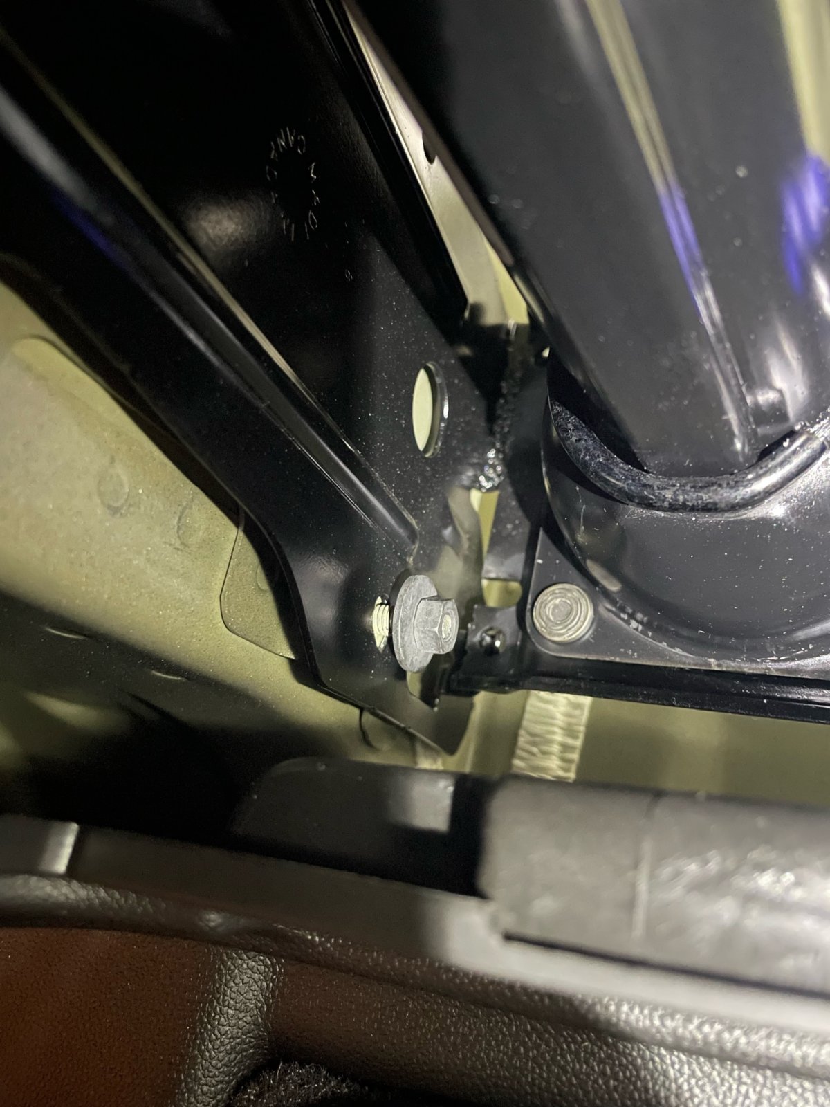

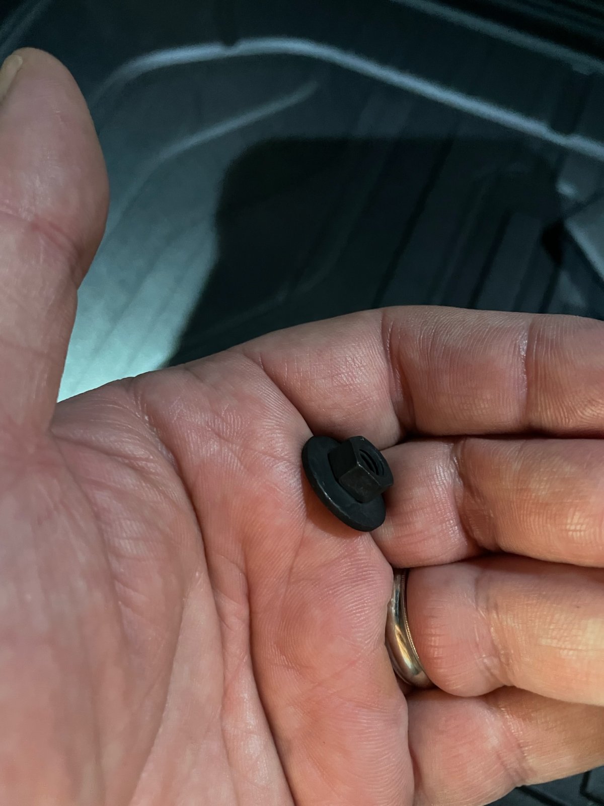

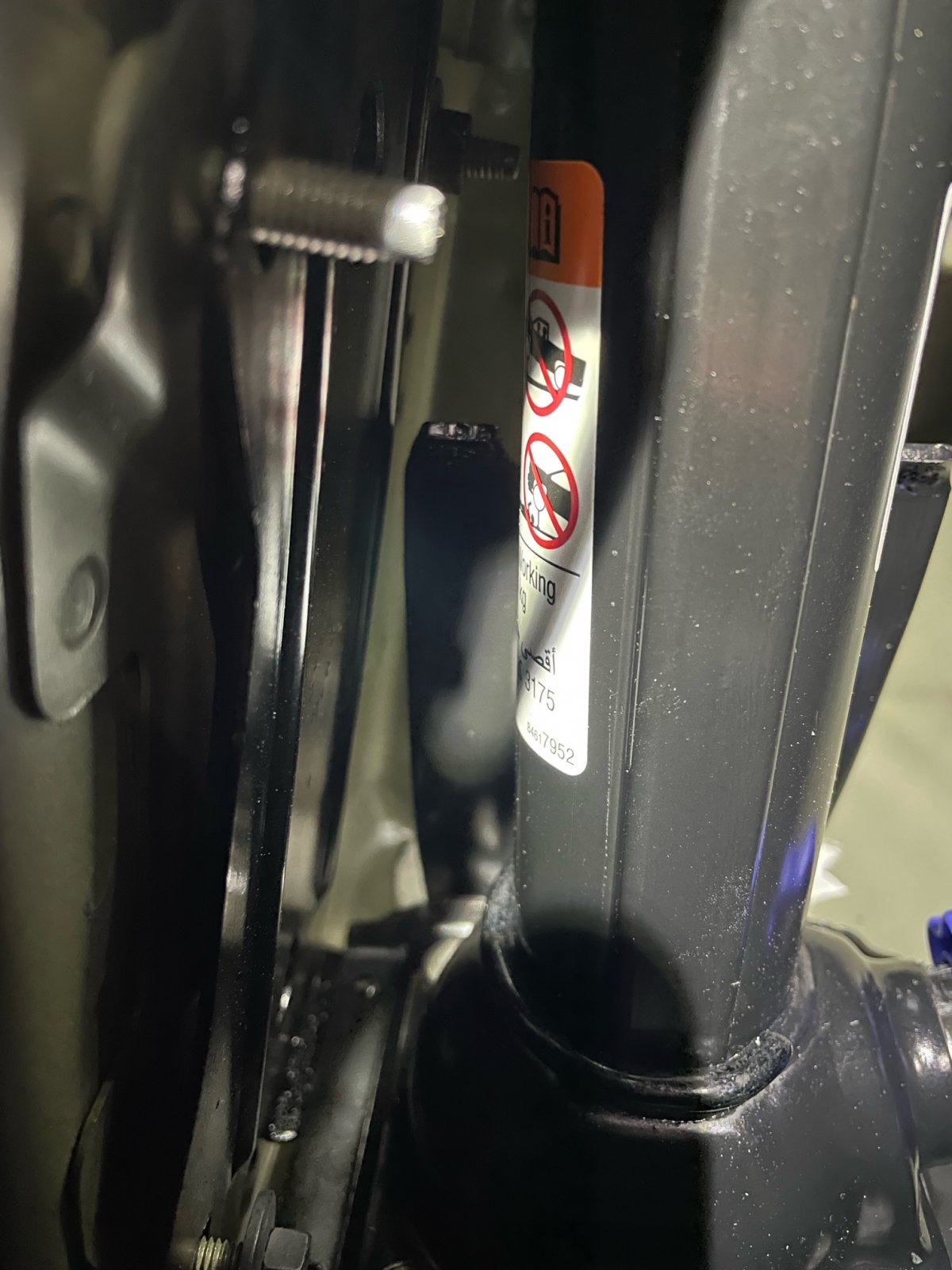

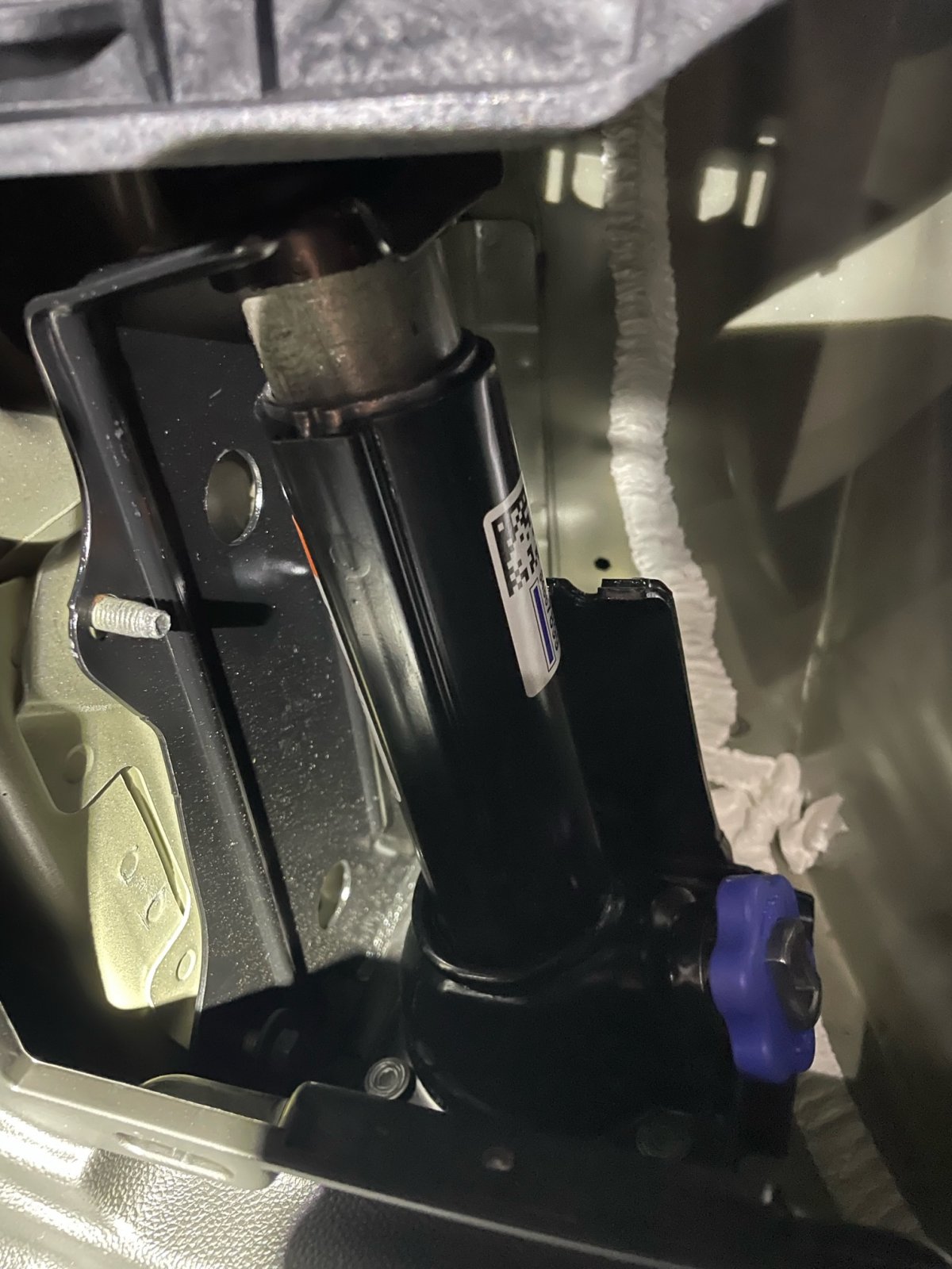

So after reading around on the interwebs I decided to look at the jack in the rear side panel. I wasn't expecting much, but it's an easy thing to look at. Lo and behold, when I open the cover and look inside I see 3 bolts that secure the jack. One bolt looks good. One bolt has the nut that is on about the 2nd to last thread before coming off completely. And one bolt is missing the nut entirely. This truck is 1 month old and has 1K miles.
So I take the jack out and start rooting around in the space until I find the missing bolt. One socket wrench session later and I've got all 3 nuts back on their bolts and snugged down. A short test drive later, where I focused on going slow and trying to hit bumps, and I'm hopeful it is as simple a fix as that.
Pics included to show what it looked like when I opened the compartment. Kind of baffling how something could be that far off of "inspected" with as little time as I've owned the vehicle. If the nuts managed to loosen themselves to that degree again, I will just put a lock washer on those posts.
