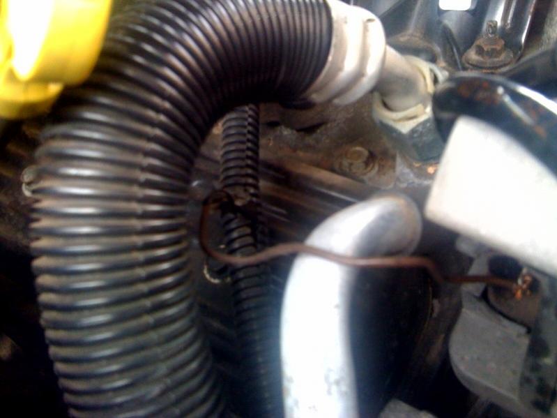

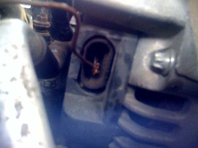

Today I had some time off so i decided to go in and clean all the terminals on my battery and grounds as I still havent been able to figure out my voltage drop. I decided to clean the Big three Wire from the Alt to Battery and i found this little strand of wiring going into the plug in area of the alternator.
I had never noticed before, but arent all chevrolet alternators supposed to be plugged in? Mine only has this little wire going into one of the male connectors.
Could this be a big part of wire i have a voltage drop when my amp is turned on or Ac and Lights are on at night?

Need a pic, but our alternators are self-regulating, I believe, so the small wire from the alternator probably just goes to the dummy light on the dash. But we need pics...

Here are some pics i was able to take this morning.[/ATTACH]
I watched a video on youtube on how uninstall an alt in this tahoe and that alternator also had a single wire going into the plug in, but it had an actual plug at the end of the wire, not just a little female connector
