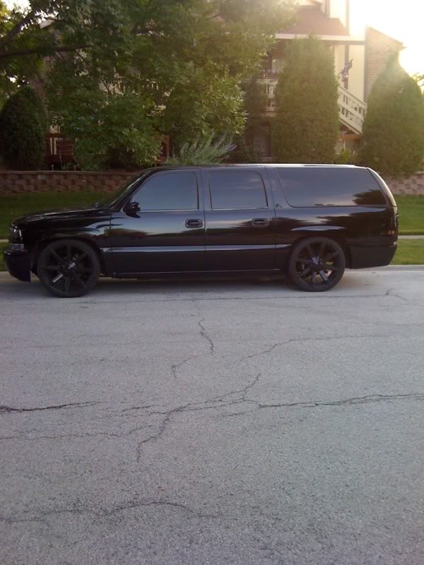

Heres how mine looks, i cut out the spare tire holder

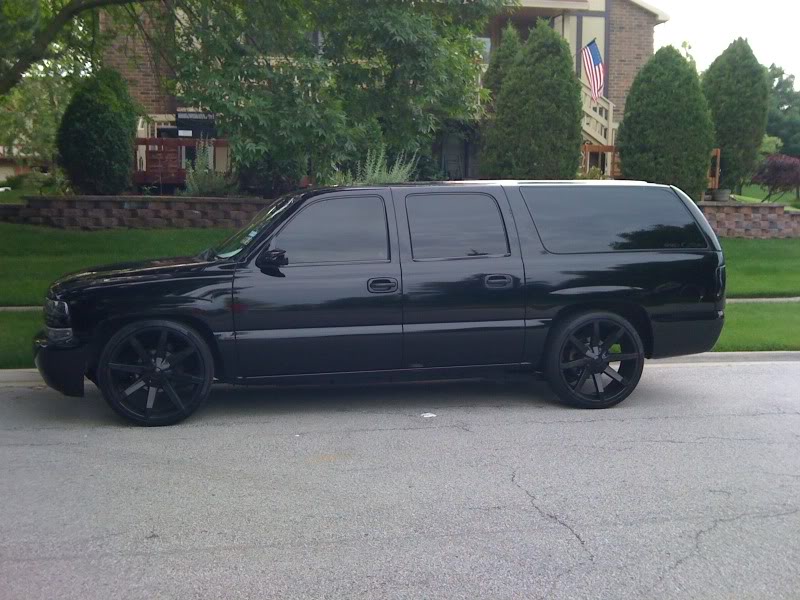

Got the rear bags installed and cut the bumpstop bracket off. It rides so much better than the 5" springs did.
I've still got to do the leveling arms/sensors and tack the lower cups in place.
It airs out not as low as I hoped, might look into different lower bag mounts as the ride tech kit has the bags maybe 3" above the axle tube. But playing with different heights I've found it rides best very close to where it sat with the 5" springs. After I get the front done and figure ride height I'll debate changing rear brackets.
Now one odd thing happening is when aired down the pass side sits lower. Any ideas? I'm going to look it over closer tomorrow

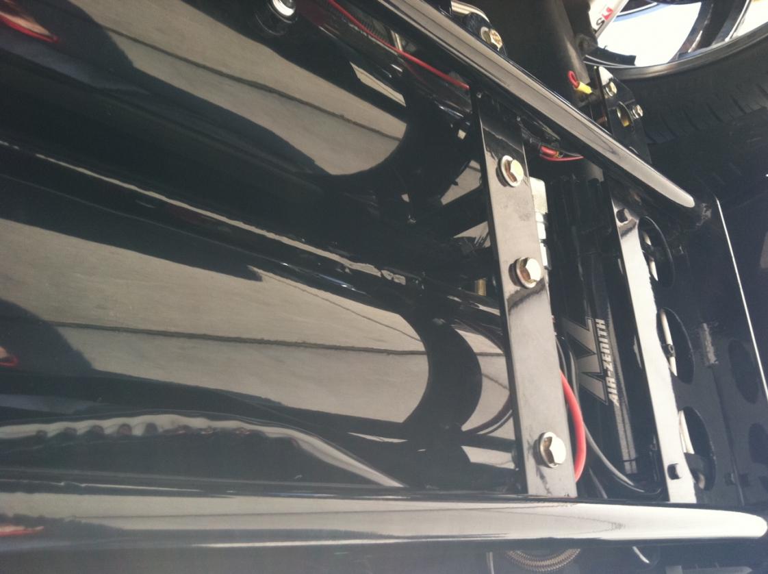

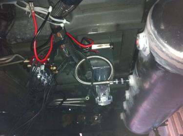

Here's a pic of my set-up.
waxworkz
Aug 9, 2010
689
damn thats a sic sub. mine looks no where near that nice. is that at ride height?
ILLEGAL REGAL
May 20, 2010
456
Tinley Park, IL
The first pic is with a 5" spring, 2nd is aired out resting on the sway bar. I've got to figure a way to get it down more. Ride height is about the same height as the first pic.
I'm thinking about changing or modifying the lower cups if once I get the front done and it's ride height won't be higher than the rear.
