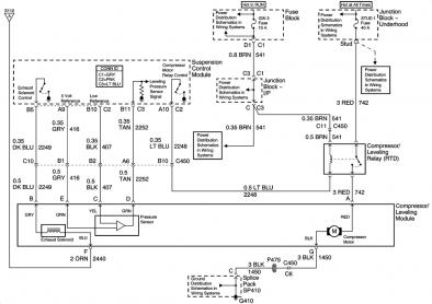

Well I have told if you disable the RTD system the factory air level ride will not work. Here is a diagram of the RTD system. you can power it up by tracking down the pin's

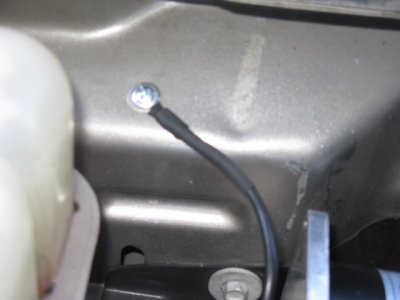

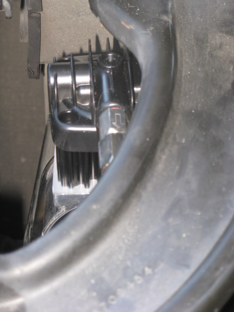

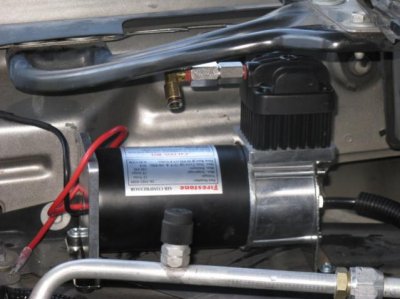

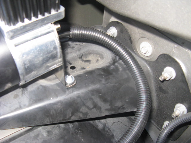

What I'm doing on my Denali...I removed the factory RTD and air shocks. I put new KYB Gas-A-Just shocks in. I installed a new Firestone compressor yesterday. and should be finishing up the wiring today. I ran the fresh filtered air for the compressor in my CIA box. it has it's own filter assy that I mounted to the inside. Then I will put my air controller in the cab. By then My rear bag kit should be here, and I will finish by replacing my rear coils with air bags.
