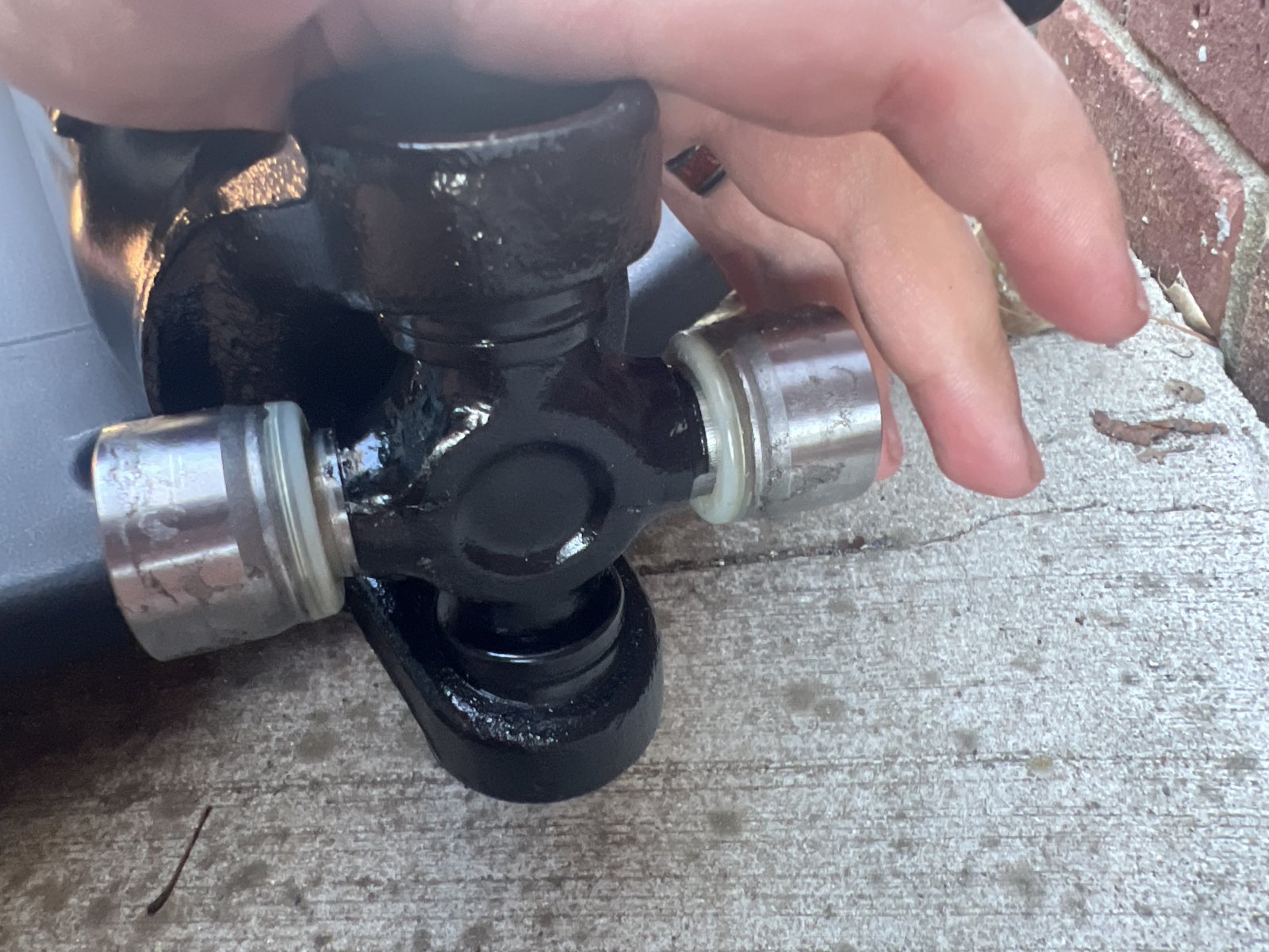

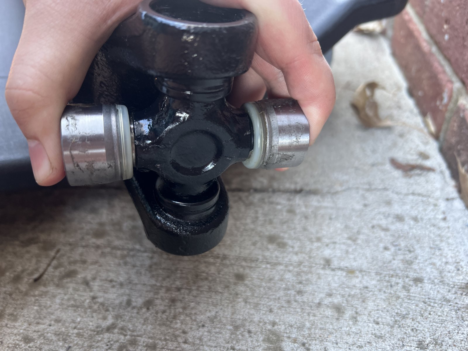

Hello this is a follow up on a previous post regarding some nightmarish u joints, well I folded and decided to purchase a new drive shaft, just got it in, no install instructions so not sure if I missed something, there was tape holding down the u joint caps towards the rear diff when I got it which appears normal, however I took the tape off and the caps push back off slightly when I try to seat them, kind of feels like there is some sort of pressure holding them from going all the way down, tried to do some research before I posted it but no luck, thank you fellers, took some photos of how they seat naturally, and when I press down as tight as i can

That's probably from the grease inside the caps and the needle bearings. I would say that's normal.
The caps are not airtight, so it cannot be from air.
Take off a cap for inspection and you'll know what I mean. Just make sure you don't lose any needles. They shouldn't fall off if there's enough grease in there anyway.

When loaded with grease and all the needle bearings fit to spec it might be as simple as the cap holding a little air pressure.
Taking the cap off is opening Pandora’s box.

You might be able to let a little air out by carefully using a pick to slip under the cap seal, without damaging the seal. Kind of like you'd do for a disc brake piston seal.
