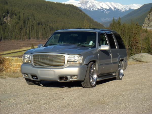

Love the truck man, and 600 km to a tank is only about 375 miles. I can usually pull 400 miles to a tank or about 650 km and I'm stock besides a dirty K&N drop in. If I go on long trips I can pull about 450 miles to a tank. Actually one time I pulled 19.75 mpg with 265/75/16 tires and stock height on interstate driving at ~75 mph
