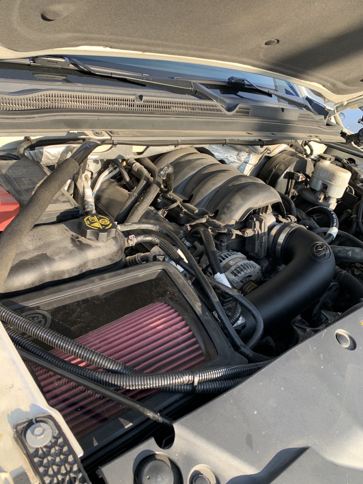

What’s going on GM family. I have a 2015 Chevy Tahoe LTZ. After installing S&B cold air intake, my check engine light came on. Any advice/ideas?

above and double check everything is sealed before you start it again.

So the maf sensor, was bought at autozone. I found out that Duralast electrics doesn’t communicate well with GM. I went with acdelco mad sensor and check engine light went alway. Thanks guys!

That’s strange because I have a Duralast maf in my Escalade and it’s been working great for 2 years.
