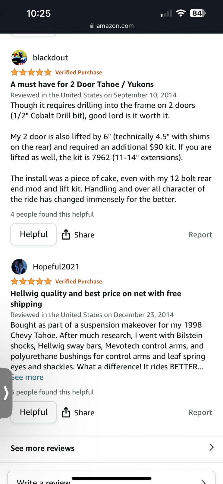

Heres what I came up with. Looking at the reviews, it appears many have put these on their 2 doors.
Anyone know of anything better than this option?

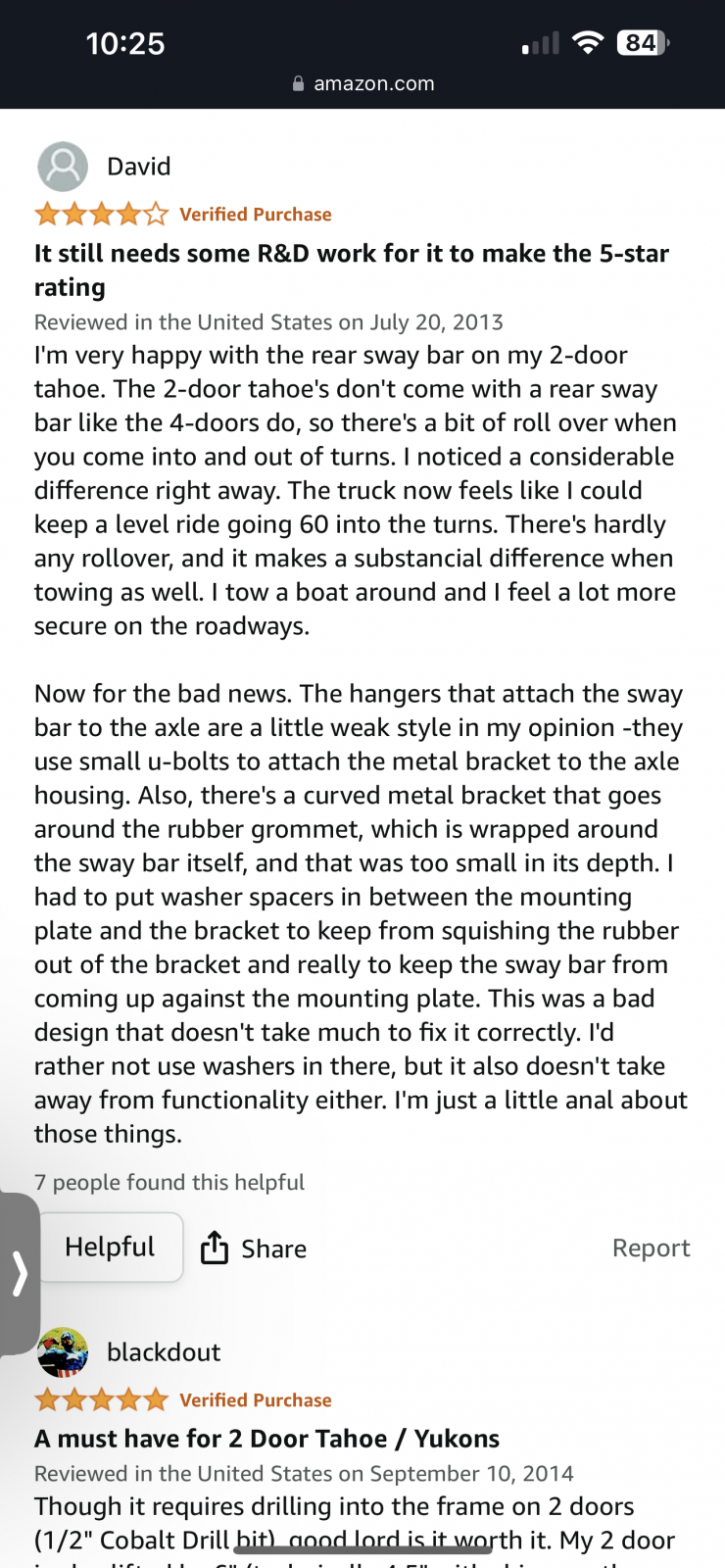

Here are the reviews from verified purchasers from amazon.

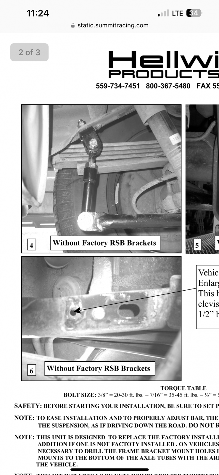

Got the bars in. Front installed no problem, but these install directions for the rear suck @$$, similar to the RCX 6”lift kit. And of course cant find anything on youtube for the 1999 hoe.

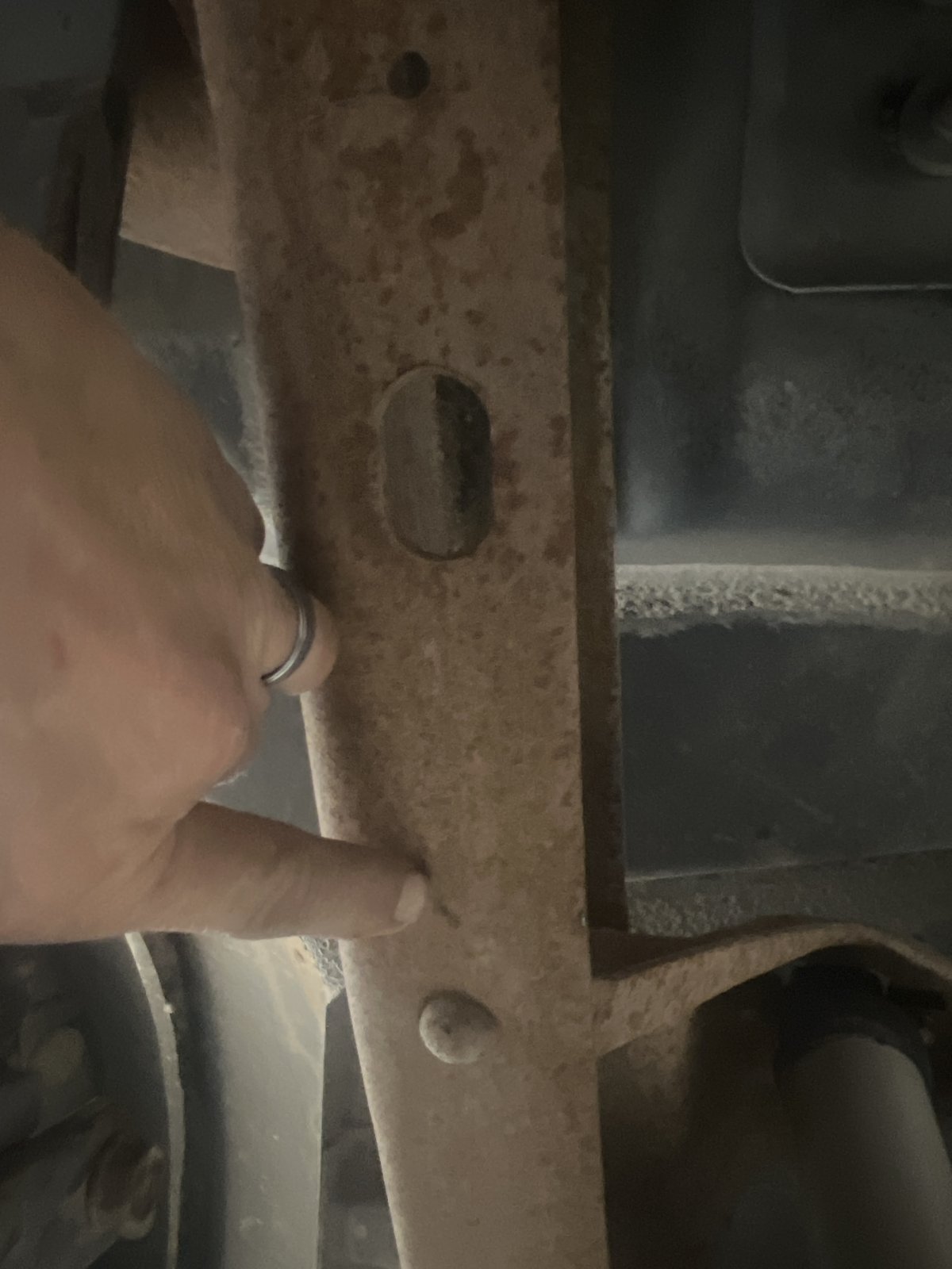

Surely someone has put these on their 2 door in this group. Need some advice/opinions on where to drill the clevis bolt hole in frame. Instruction/pictures that came with install are not the same. I have attached the instructions sheet and a picture of my 99 2 door frame. I think I need to drill hole where I am pointing. Thoughts?

Interesting. Did you call Hellwig and ask them for their opinion?
