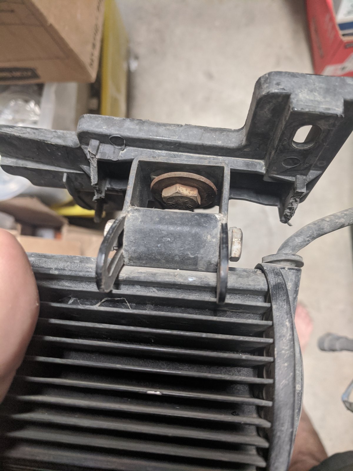

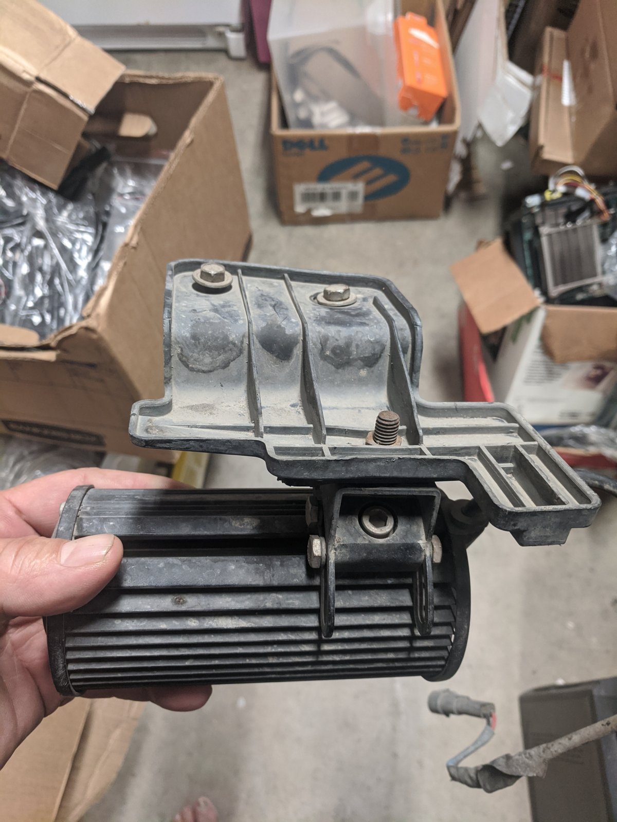

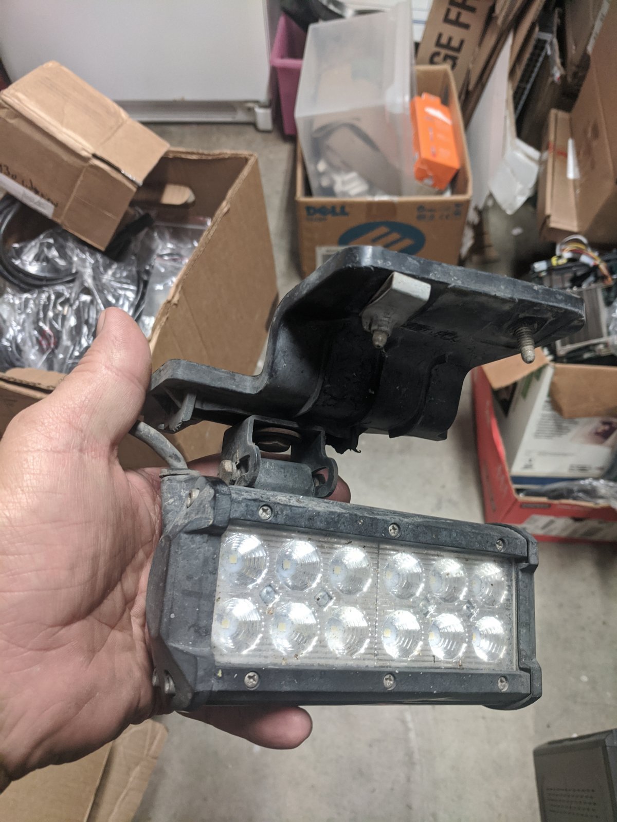

I did that for a while but I found that oem fog light housings tend to get water in them in the winter and it pops the bulb, then I tried some waterproof projectors those worked but the light output was whack, then I went with some rectangular 12 led light bars (1 for each side) and those work fantastic but you have be creative with making a bracket I took the oem light apart used the mount from the oem fog lights and drilled a center hole and mounted them that way, the mount is plastic so over time it will wear out sometimes they crack so a small metal bar may help. whatever you use it has to be something you can assemble and align on the bumper it can be tricky to mount them.
Have a pic of them @Doubeleive ?
