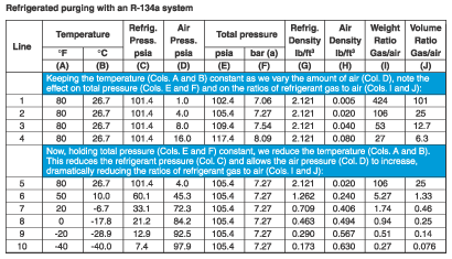

These moght help.

Awesome, so I am close :) I will call it good.
