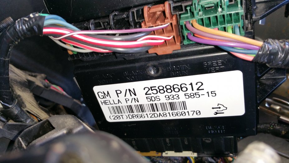

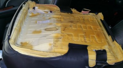

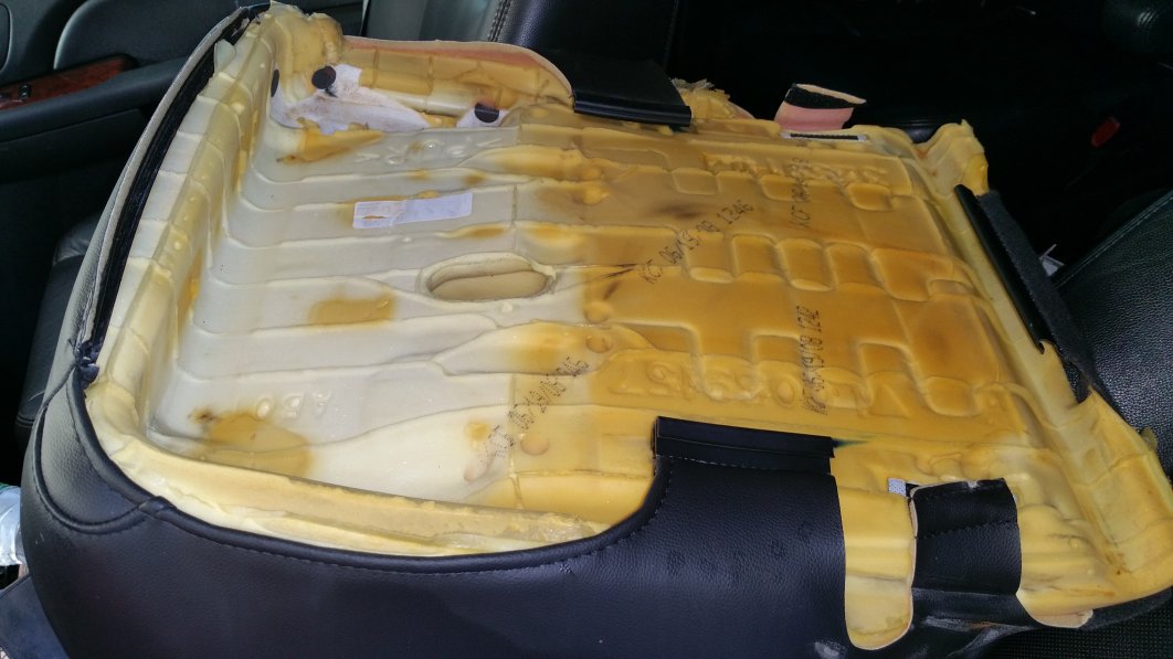

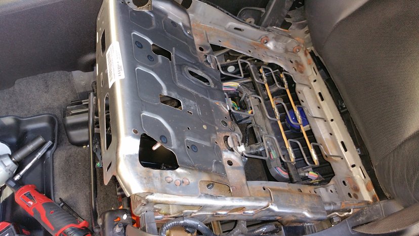

I dismantled my seat today,the seat cushion is probably unnecessary to replace.The blower motor is fine,I plugged it on the passengers side it works fine. So I believe my seat module is the suspect. I had one replaced on my 07 Escalade under warranty some years back. Only problem with replacing the module on your own is that the dealer has to program it. :chair:

20150218_150635.jpgThese are some pictures of the drivers seat

The new part number for the drivers seat module is 25862038
