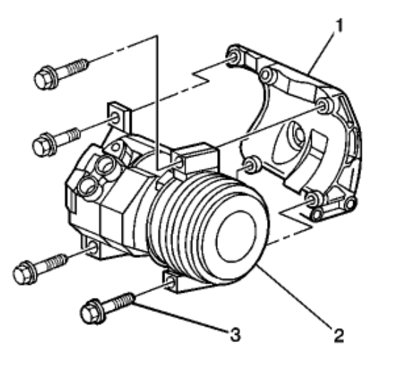

This is all I could find. Hope it's helpful.

Be careful with the compressor connectors otherwise it’s pretty simple unless it’s very different than the picture makes it look compared to my 01

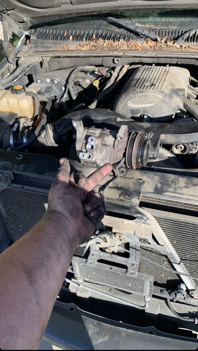

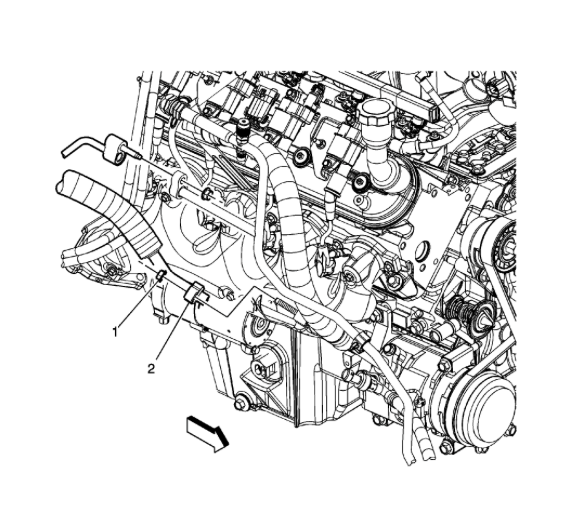

General Instructions: get good snap ring pliers,get system evacuated unless you hate the environment or r134a spraying in your eyes, jack car up Atleast on passenger, remove skid plate/tire, remove wheel well , remove thingy that shows the belt diagram , remove the grill, remove passenger headlights and bracket (MAY REQUIRE T20 security bit with no center pin) , remove all the lines in any order (self explanatory should be a 13mm at times long extensions help but aren’t needed), set up drip pan under the compressor, remove the 4 15mm(?) Unless they changed, remove it the intake (should be 2 8mm bolts/flathead) if you still have a ac belt on that you don’t want to cut off. , then you get to the fun part of actually removing the compressor get ready to twist it around and back and forth for 2 hours. until it falls out between the frame and passenger wheel well, then do the condenser you can do it before the compressor if you want it doesn’t matter the order IMO nothing stopping you from doing one first but once the compressor is out unless you have magic hands this is how you’ll feel and you’ll probably be done for the day car repair wise. The rest would be at the mechanics or reverse of what you’ve done unless you do the expansion valve or rear ac lines.EDE45C96-DF6F-4471-9E1C-093E5DACFB9C.jpeg
