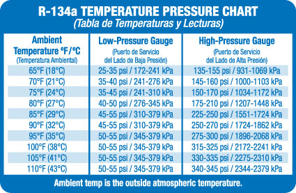

Whats the ambient temp? I have had better results with closer to 60psi on the low side but, its typically 90*+ when I hook up gauges.
I live in Phoenix so it’s current like 105-110 outside. That being said, I have a thermometer placed in the grill to get a reading and it’s only 75-80. It’ll get slightly cooler with recirculate. My Tahoe used to get VERY cold! I might try putting a new dryer and condenser on it but I really don’t think that’s it. I might have better results with a blend door actuator or something… I dunno
