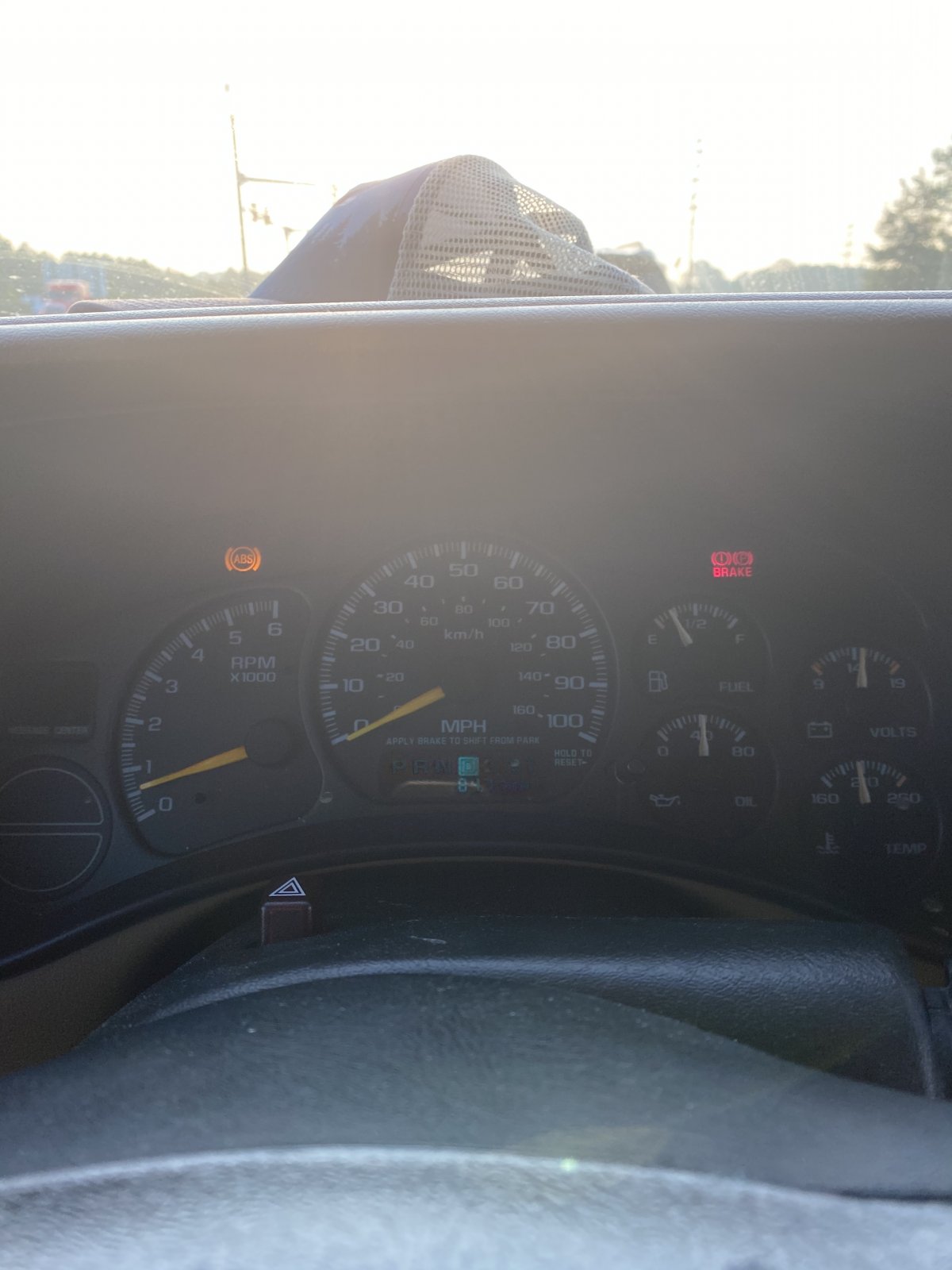

These indicator lights come on at random times and I can’t figure out what to check for to address the issue. Some trips it comes on right away, other trips it’s maybe after about 4-5 miles. Other trips it doesn’t come on at all. I’m stumped.
2000 Tahoe

Have seen threads about this many times and appears that mostly it is the wheel speed sensor and is caused by a problem with the hub bearing. Loose hub bearing. If you drive straight and turn slightly to the right as you do, that loads the lf hub bearing and the opposite for the other side. Does the lights come on, when they don't come on right away, right after turning?

abs module under the frame right under the drivers seat, it's bolted from the top with allen head screws, 50/50 chance you can get it out without stripping the bolt heads if you live in a rust free area. you can TRY to repair it yourself or send it out to be done, once you have it out the lid is pretty tough to cut open but once you have it open I would take it to a expert solderer and once it has been reflowed then you want to seal it up with some premium sealant and be generous because it is subjected to the weather under the truck. took me 3 tries to finally get it fixed. also if you manage to find a good one at the junkyard it is plug-n-play as long as the numbers match exactly, so it has to be one from a identical vehicle.

I agree with several other members, it’s the solder welds on the ABS module causing the issue. Great suggestions from all on removing and reflowing the welds. Dorman also sells remanufactured control modules. They vary from 2wd, 4wd, awd, and traction control equipped models. It’s also not a bad idea to clean up the driver side ground as one member mentioned as well.
