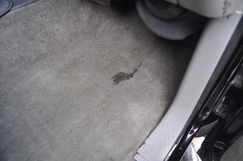

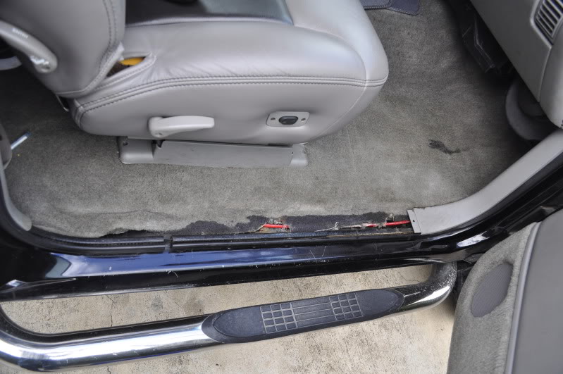

Hello......I was looking for a little help with this leak I've developed on the passenger side. Every time it rains I get water collecting where the bottom part of the door meets the frame. In addition, but not always I start seeing water soaking through in the middle of the floor board. I can't seem to pinpoint where it's entering. And the fact that it's soaking through the middle of the floorboard leads me to believe that this might be something more internal. Ive replaced the outer molding (rubber strip)....but to no avail.
Any thoughts?
Thanks!
Here's some pics to better describe the problem. In addition to some outside pics. First ones uploaded.

Check to make make sure its not your heater core...had a similar problem with mine but you'll notice your heater not getting hot and start smelling anti-freeze if thats the problem

Ahh yes....the power of the search button that I failed to use. Thanks for the links. I suspect I'll get to the bottom of it. Definitely not coolant, for sure it's water. Ofcourse it would happen right when I change out the carpet.

basically it should the be cowl screws or the windshield seal. did read up on another site that it was coming in through a body panel seal behind the right front fender.

Nice Hoe! I had the same problem in my 95 silverado and it all started when I changed out the front windshield.

I did have the front windshield replaced about a year and a half ago.....but the leak started just in the past few months. Whats throwing me is the fact that its also in the floorboard isolated from the door. And it sometimes leaks from there.
