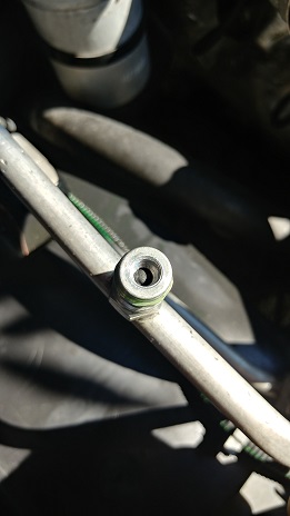

Hey guys, this is what is on my 2004, it is the OEM high side valve/port. Not sure if/when they stopped using this style, but I know it is on my '04 Yukon XL, was on my '03 Yukon XL and '01 Tahoe Z71, '01 Camaro, and '00 Regal GS. All had this rubber stopper style. I have replaced them before, with more of the OEM style. Are you saying there is a serviceable schrader valve beneath the rubber that can be replaced without removing the entire valve port? That would be news to me. :) Or has everyone else just already had theirs changed to the schrader style (knowingly or unknowingly) and I am late to the party?
That little bit of green around the lower rim (where the bottom of the red dust cap would be when it is on - obviously off for pic) is leak dye. It doesn't leak until running, so 200ish psi, why I didn't find a leak when I had my gauges on it, or afterwards when shutting it down and making sure pressures stayed stable. What a wonderful surprise to smell it the next time I went for a drive...

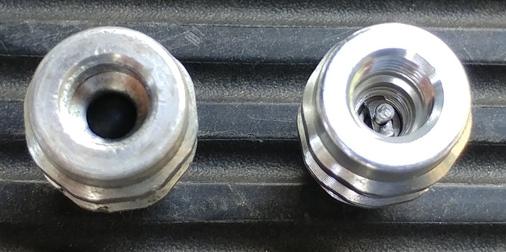

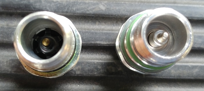

Had time today to make the change over for the A/C high side service port, and got those pics. Since this has been viewed several hundred times and no one said they had any adverse side effects for those that had the schrader style, I went for it.
Top side, left is the OEM "rubber ball" or "poppet" valve, heard it referred to as both, right is of course the schrader style.
Bottom side, can see how very different the types of valves are, with OEM using a plunger to keep the rubber pushed upwards to maintain seal, installed from the underside. I attempted to remove it, but that wasn't happening with all those retainers holding nice and tight.
Anyway, it is changed. Pretty sure GM still uses the rubber type for the high side even on the vehicles they are making today, so it makes me wonder why the engineers feel the need to use them instead of traditional schrader valves. Here's to hoping I haven't done my a/c system a "dis"service... that was horrible... I'll stop now

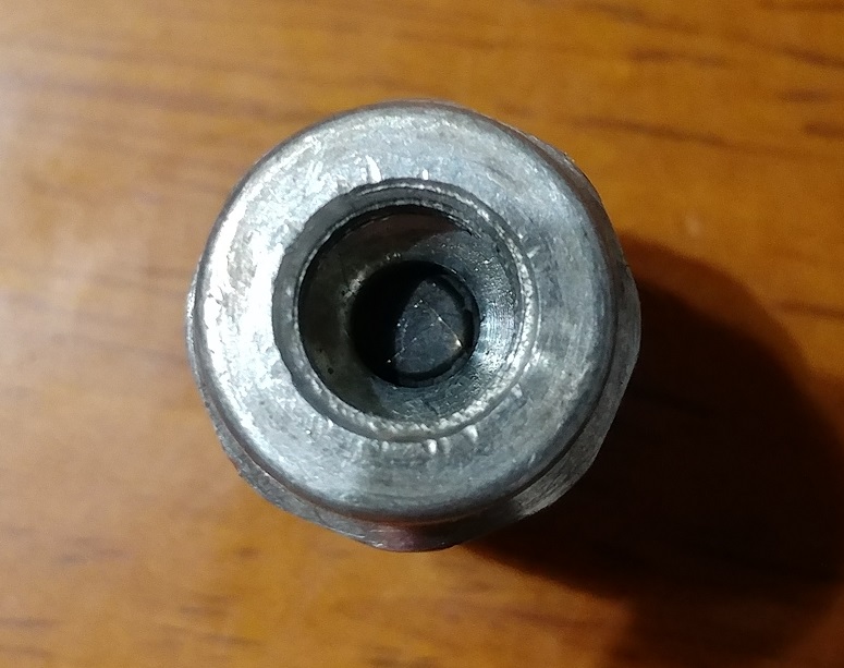

Are you sure that’s not a schrader valve with an extra rubber seal? Anyway Im pretty sure you’re good.
100%
It is clear in the pictures that a schrader valve would not fit (inner diameters are different, as well as no threads).
But I dug it out of the trash, pulled the rubber out with a pick, and took a picture of the plunger that keeps the rubber in place. Definitely a different style valve, and non-serviceable (only replaceable).

100%
Interesting. I never even noticed the difference when I did mine so I didn’t look into it. But 3 years so far, ac blows super cold. Before I replaced both, the charge lasted at best one summer.
