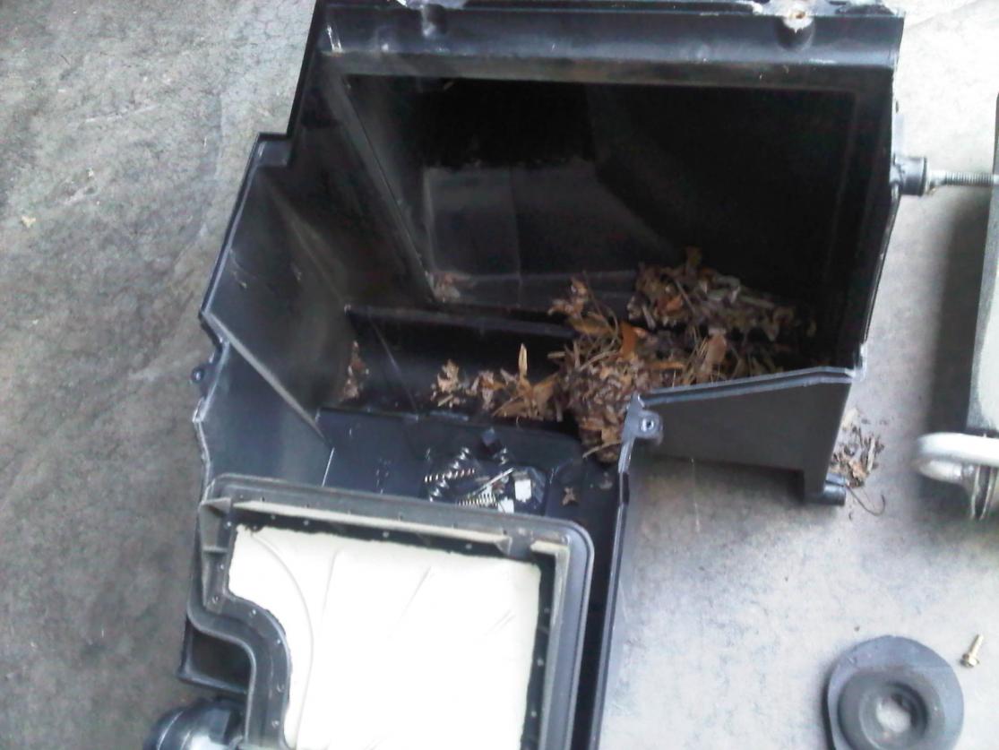

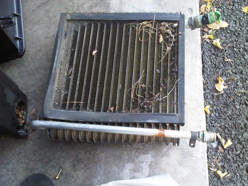

Okay played like hell but i got the dam assembly out. Here are 2 pics of the evap and evap assembly. How the hell do they got all this crap in there? Im glad i got it out and didnt give up, as dirty it was in there. I hope i get it all back and working.....hahaha....
