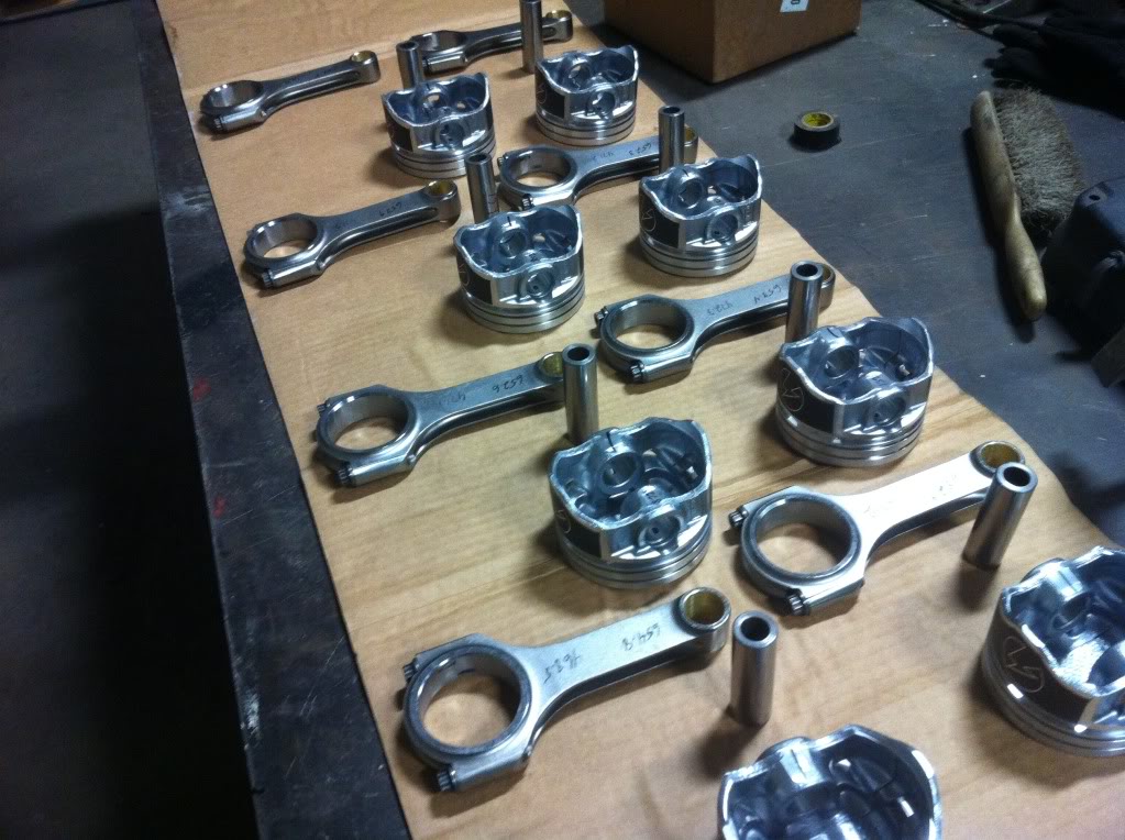

Right now the truck starts and runs. No oil pressure once it warms up but at least I can move it around. So I didn't want to pull engine until I got the new one done. I had a 350 4 bolt main sitting in garage from an old square body dump truck I bought for the axles. Brought that to the machine shop and had it dipped, magna-fluxed, bored, cam bearings replaced, lined bored, decked, boss' drilled and tapped for roller cam, clearanced for stroker crank and freeze plugs replaced.
Next I started ordering parts. **** steel crank, H-beam rods,speed pro Pistons with Teflon coated skirts, all ARP hardware and had the rotating assembly balanced.

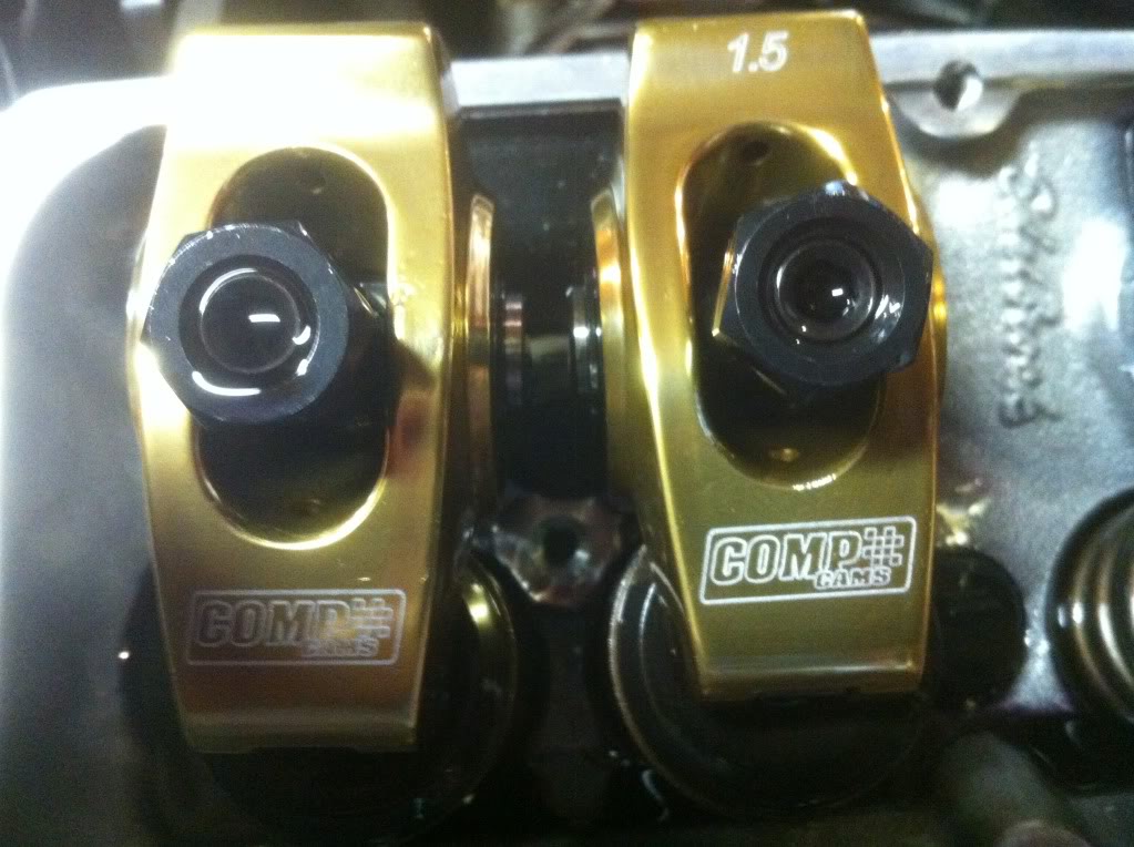

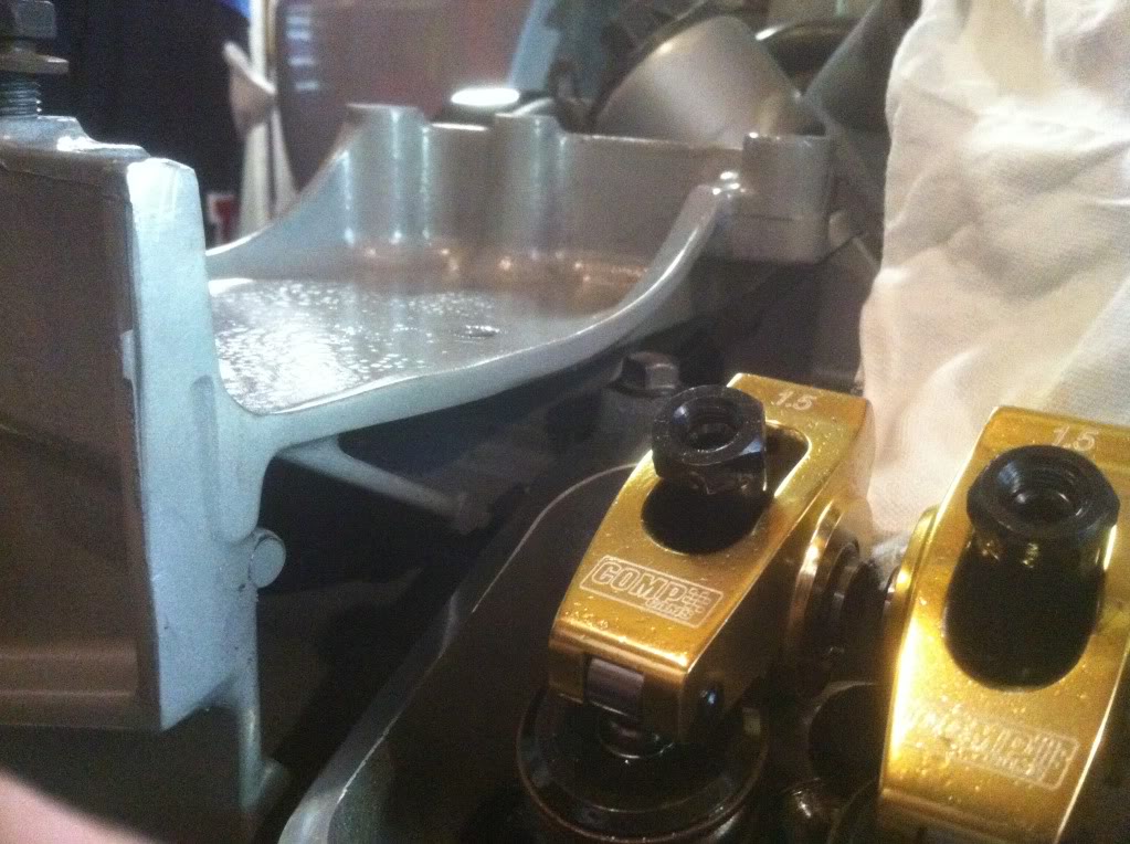

As you can see in the above pic, I decided to go with Comp Cams gold rockers in a 1.5 ratio.
The pushrods may have worked in stock length but I installed my pushrod length gauge and decided to go with ons that were .020" longer. Gave me a better pattern on the valve stem. Kinda hard to tell from pic but the extra length centered the roller on the valve stem better than stock through its cycle.

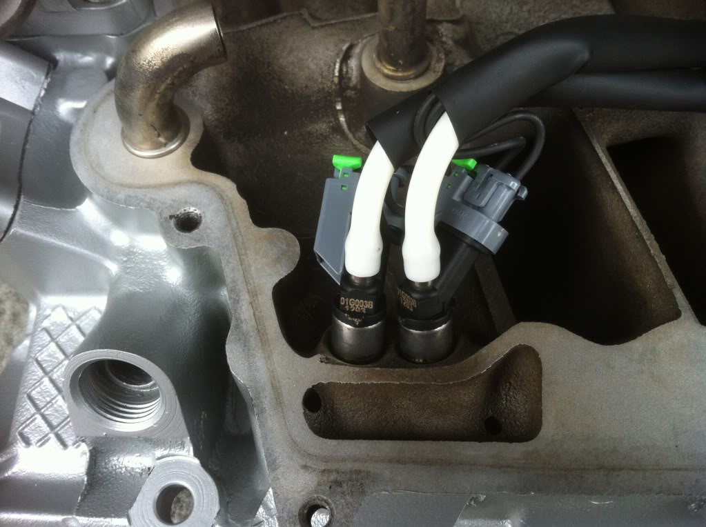

For injectors I ditched the sequential fuel injection and upgraded to multiport which moved the injectors down into intake runners as oppose to the poppet style that always seemed to carbon up and fail.

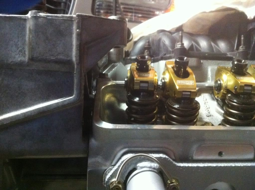

First road block was with the rockers. I couldn't use the center bolt valve covers because they aren't tall enough to clear. Sounds simple enough, right? Yeah, I found a set of Edelbrock covers and luckily the heads have provisions for center bolt or perimeter bolt. Same with intake, there's holes for vortec manifold and regular. Makes it nice for if I decide to go with a different intake. The real issue is with the serpentine brackets. The AC bracket hangs over the valve cover on the drivers side. So my new valve covers fit over the rockers but not under the bracket.
my cure was to remove the rear outside mounting hole.

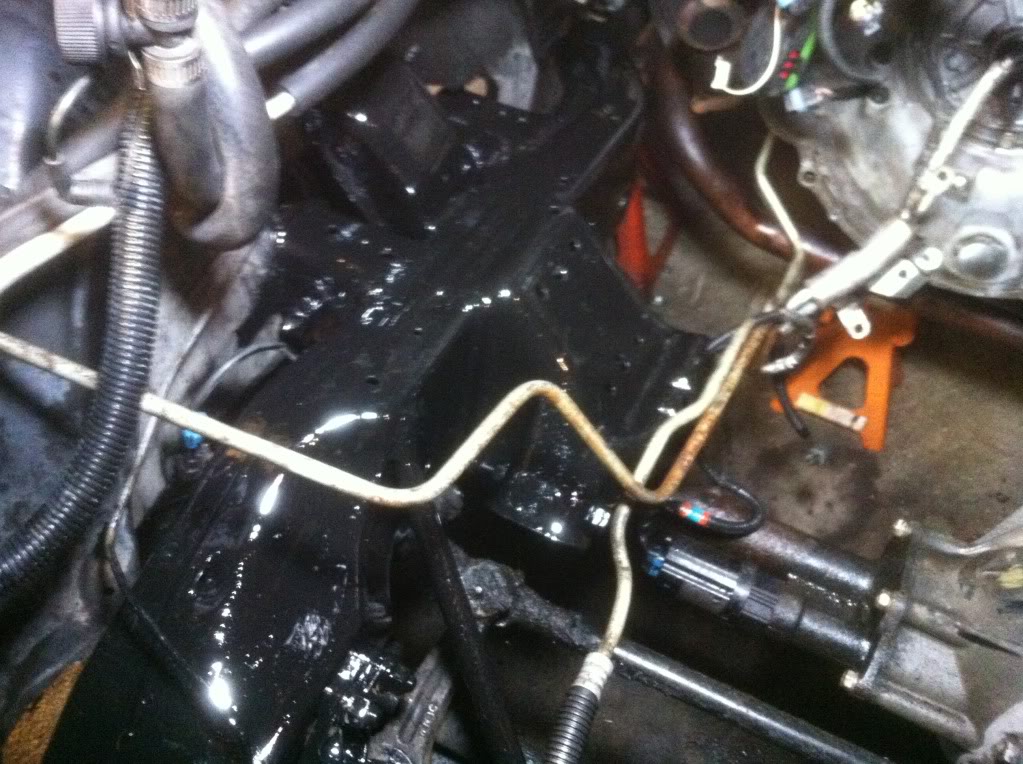

I cleaned up a lot of the wiring and spent a good 5 hrs washing, wire brushing and wiping down the frame.
Fresh coat of POR15.
Looks so much better after it cures.

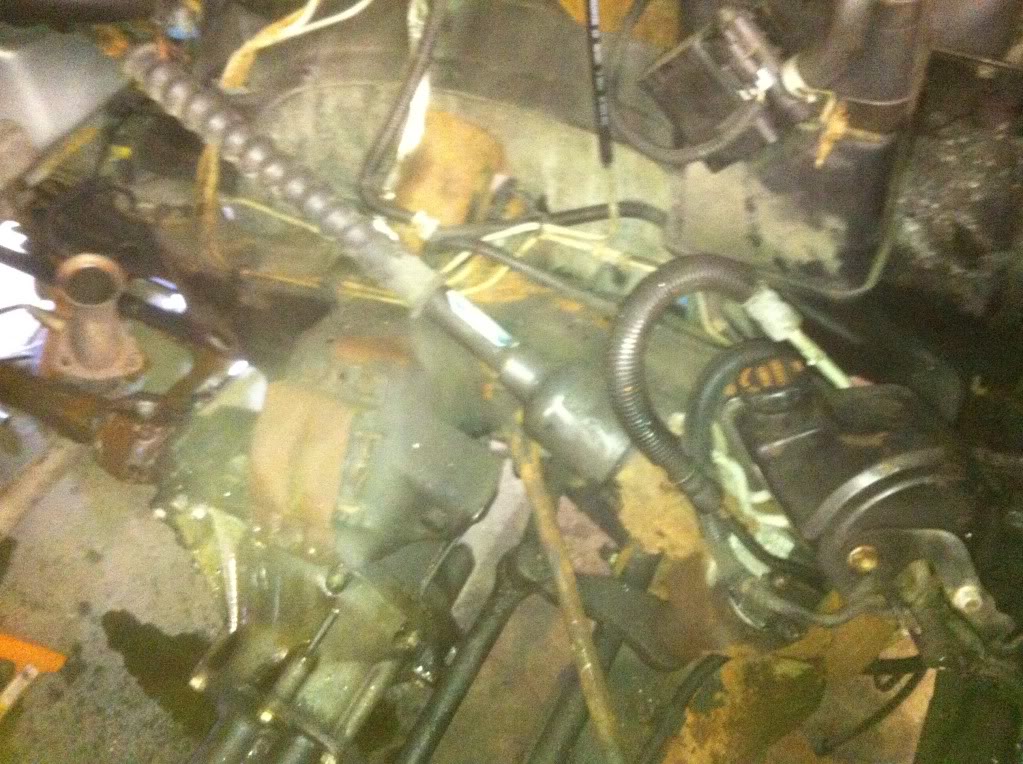

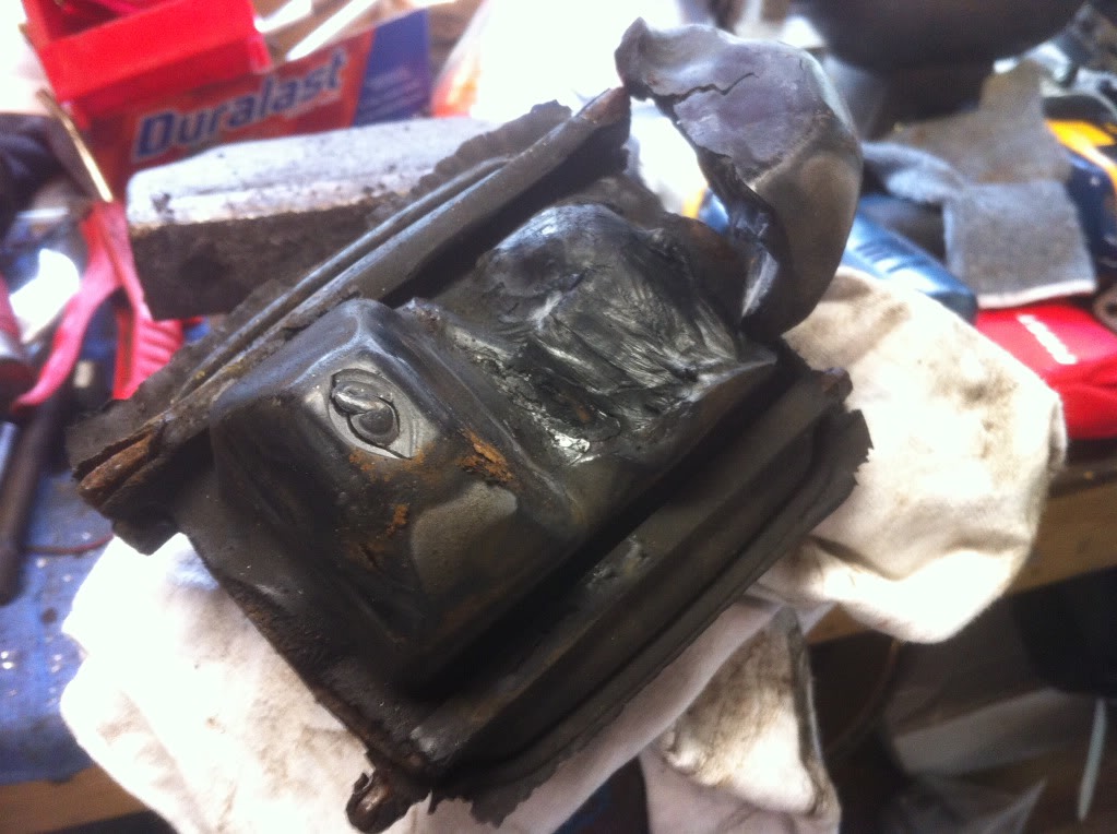

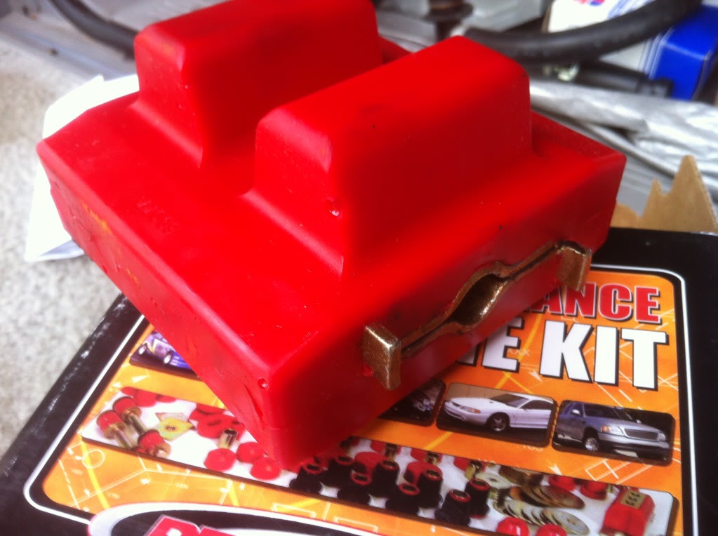

I pulled the clam shell engine mounts apart and found this.
Time for some new poly mounts.
Before I drop engine I had to address the trans. It's a 4L60E, not my first choice but if I wanted it to have any chance in hell to survive, I needed to upgrade. Fist I replaced the trans lines and added a cooler. Next I dropped the pan and installed a shift improver kit and changed the filter. Friend of mine gave me a name and number to a company in Cali that builds torque convertors. The TCI unit I was looking at was very expensive compared to what I paid to have one built. Again, I discussed with this guy on the phone what I have done and what vehicle it goes in and we agreed that a 2300 stall would be good for my application. When that came in I put some fresh ATF in it and threw it on the trans. Ended up going with Mobil1 synthetic ATF. Sorry, no pics. Photobucket dropped them somehow.

Still running into an interference with them valve covers. The AC compressor would not fit down onto the bracket. Time to improvise again. What I did was make a few spacers and got longer bolts so the AC was 3/4in above the bracket. Had to go to a longer belt to make it work but it works, that's all that matters.
