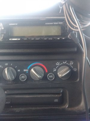

Ok. So this is what I found out today. The whistle only happens when the temperature control is set all the way cold. As soon as I get 4 "clicks" warmer, the whistle goes away. Does not fade out, it just stops.
Happens with the fan on or off. The a/c doesn't matter - on or off it whistles.
Until I go warmer, then it stops. I turn it back cold and the whistle starts again.
Tried every combination of idle, moving, a/c on or off, vent, feet, defrost. It blows hot and cold as appropriate. It just whistles when temperature is set to cold
The pic is the point where the whistling stops.

Check the vacuum line to the heater control valve. There is a soloniod on the firewall and the hose from it should run to the heater control valve which is basically below the air filter. The heater control valve is a black plastic thing with two hoses in and two hoses out that run to the firewall. Link to image
https://www.rockauto.com/en/moreinfo.php?pk=84579&cc=1061356&jsn=753
east302
Dec 21, 2016
1,687
1,686
Mississippi
Sounds reasonable. The solenoid is energized when the temp dial is set to the “max” detent. That then applies engine vacuum to the heater valve.
The solenoid has a hard vacuum line running from the PCV fitting and across the intake. The soft vacuum line goes from the solenoid to the heater valve.
Sounds like the soft line could be disconnected/broken if it only happens when MAX is selected.
