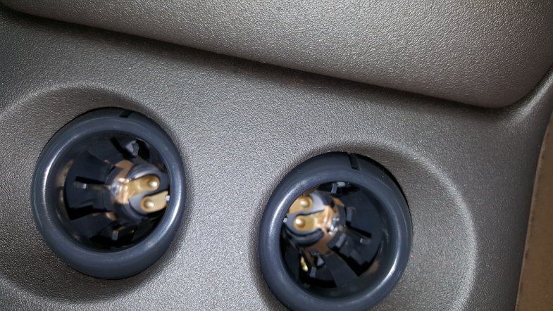

Can you let me know if my map lights are missing a piece? Is there some holder with the glass piece in which the bulb fits into?

Figured as much, I'll be in the look out for them. Thanks Bowtie.
