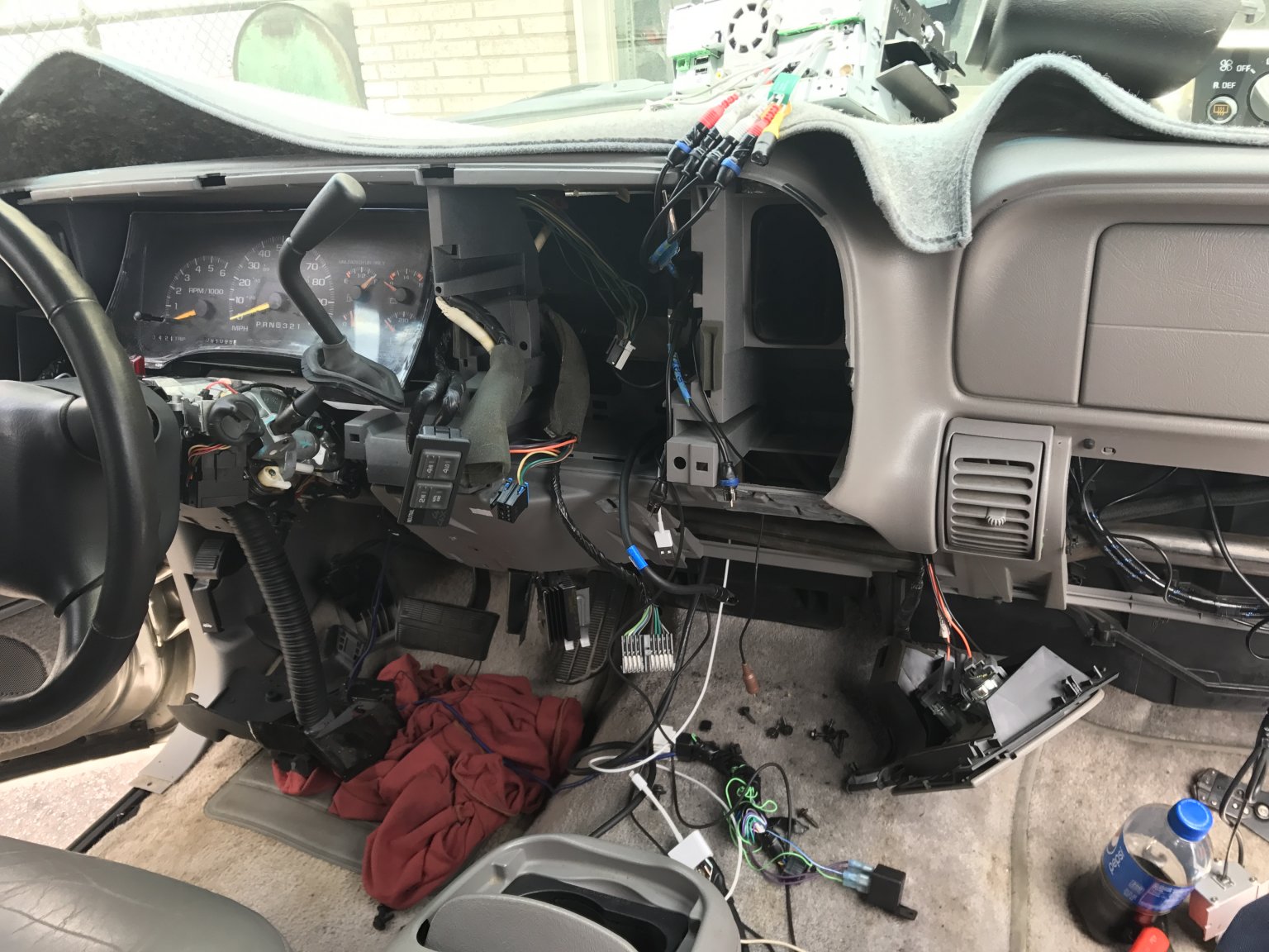

Just wanted to let everyone know, I went with the Metra to hold me over on the install while waiting for TheDetailSS to get back to me, Finally he sent me a message he said sorry for the delay he shipped my dash kit out and paid the shipping for the wait. This thing is awesome I highly recommend it. Ill show pics when im done with the install, currently trying to locate the reverse light wire that has power while in reverse for my reverse camera to work like factory and turn on when I shift into Reverse, any info on this for your guys double din install?

A few pics of how the install is going, not too bad. Be careful when your cutting, in the last picture there is a grey piece in the back, behind that is a wire harness. Be very careful cutting that whole piece out, espically the the left side there's a harness that goes down and is very hard to get to.
