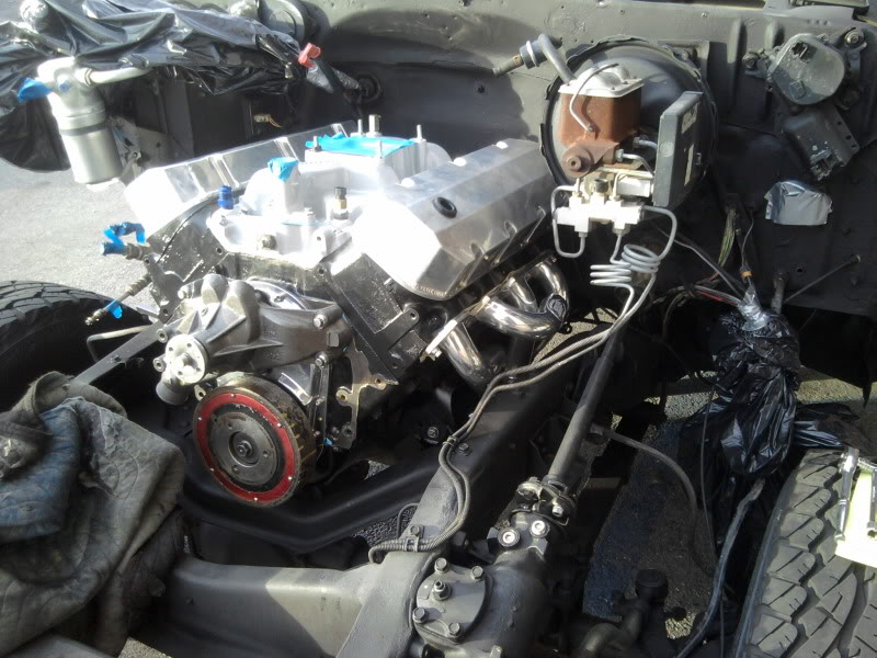

Wanted to give an update on this slower going project. Finally got the motor in the truck. Had a loooot of mount trouble. I went through 3 or 4 sets before we found the right ones, that sucked. Everything is bolted together, motor to frame and trans. I got the headers mocked up and they'll fit, I just had to remove the bumpstop bracket for the front diff. My bolts finally came in, so I can install my new valve covers when we're ready to go. I need to put the front end back on and start running fuel, oil and trans fluid lines to the various coolers and tanks but that will come a little later.
On to pics:
The headers:
