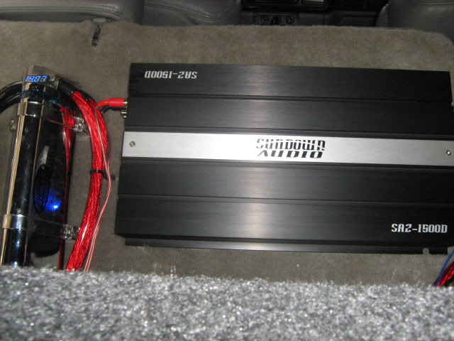

I'm currently running 2 RE SX 15's powered by dual Sundown Audio SAZ 1500D. My enclosure is 8cubes (4cubes per sub) tuned to 32hz. I've been throwing around 1700WRMS to each sub as a daily street beater and they're still going strong. I've never been metered but my output is very decent. I am looking to go in a different direction woofer-wise. I may do a single 18 and strap my amps together.

too many variables to accurately say...
sealed or ported, what amp, what gain settings, what volatge, what impedance, etc,etc
Well stated my man.....I used a multimeter to match the gains on my amps to the voltage coming off of my HU. I will admit that the SX's are slightly underrated as I've been running them for over a year without frying the coils.
