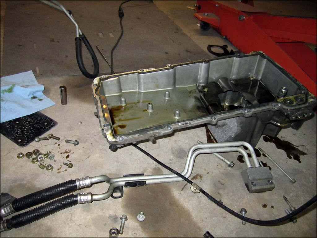

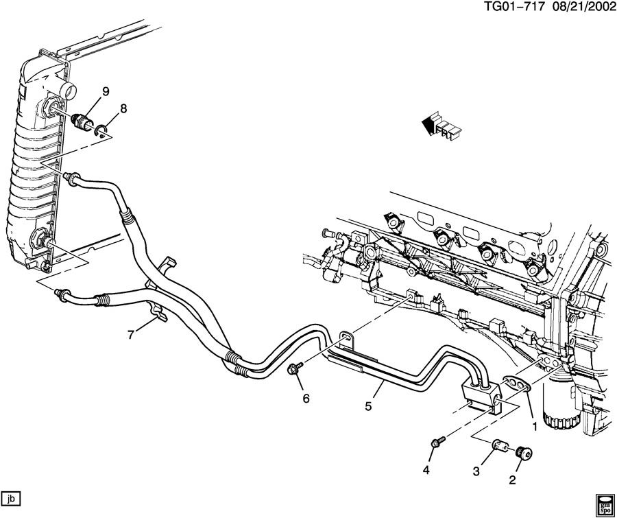

You should. They are item #5 in the picture. 2 rigid aluminum lines coming out of the driver's side/rear of the oil pan around where your oil filter is.
Item #4 along with the crimps at the rubber sections of hose is where they usually leak.

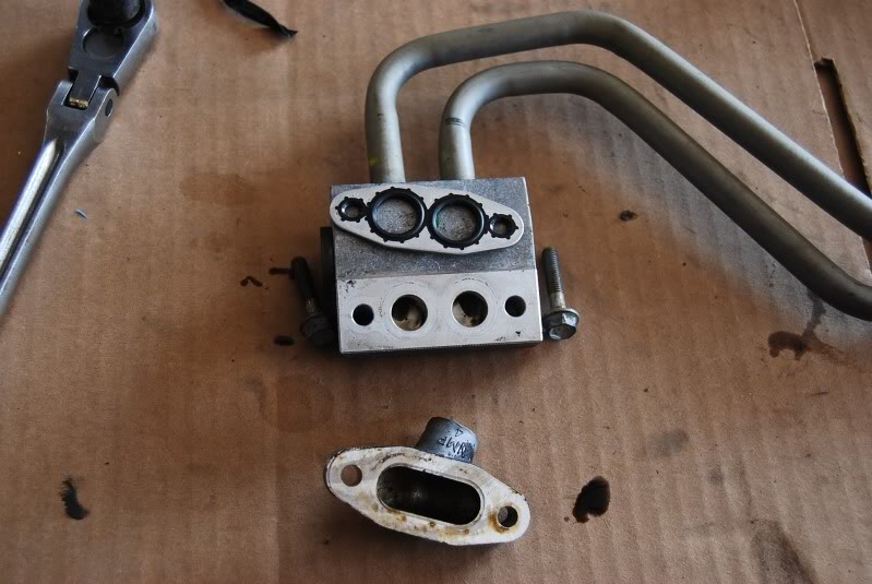

In this last image is the lines and gasket (the gasket is usually what leaks in that section) and below is the block-off that would be in the same place if you did not have an oil cooler.
