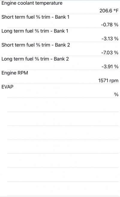

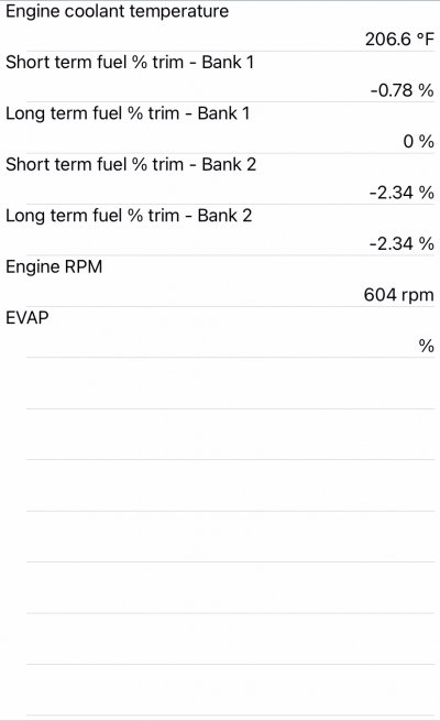

Can you see what the PCM thinks the engine coolant temp is when it happens?
I will check that when I leave work today as it will more then likely have the extended crank.

So I did another live data won’t let me post the recording of it but here are pictures idle ,1500rpm 2500rpm and engine off key on.

Nothing extraordinary in the Bank 2 trims. Do the Bank 1 trims look similar?
