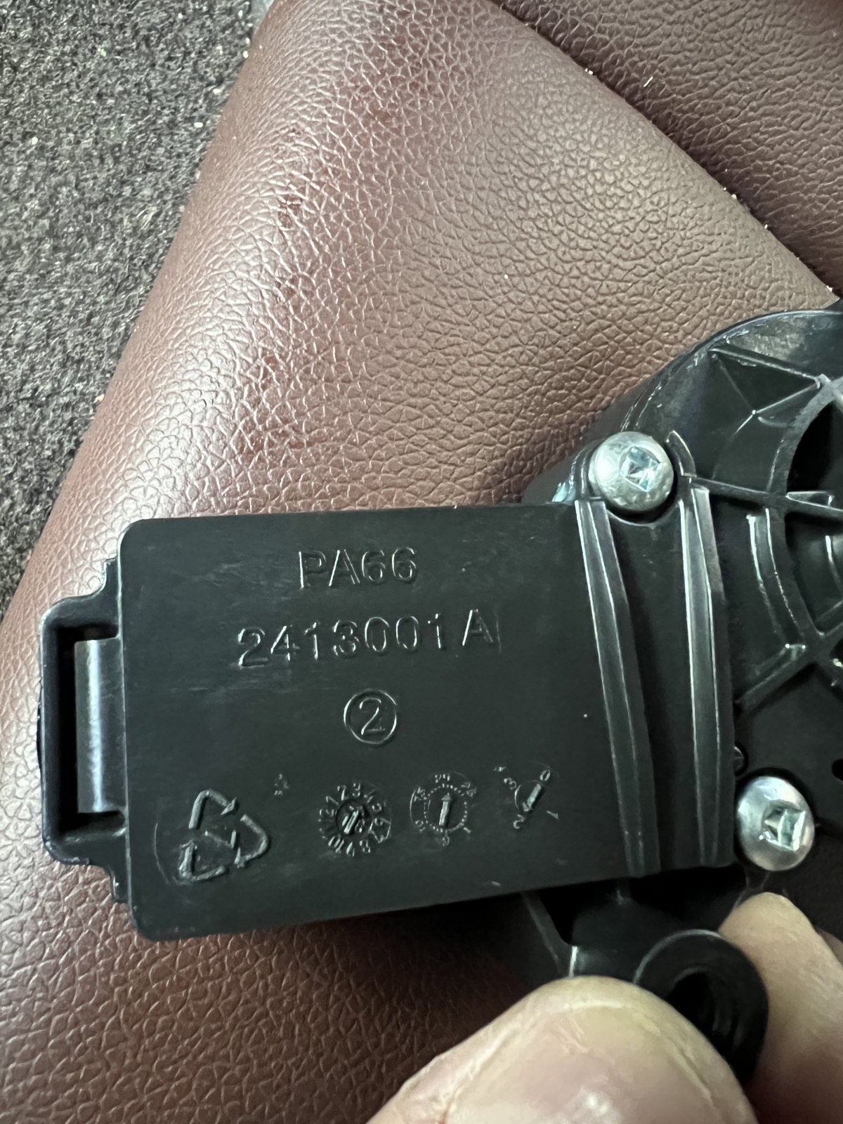

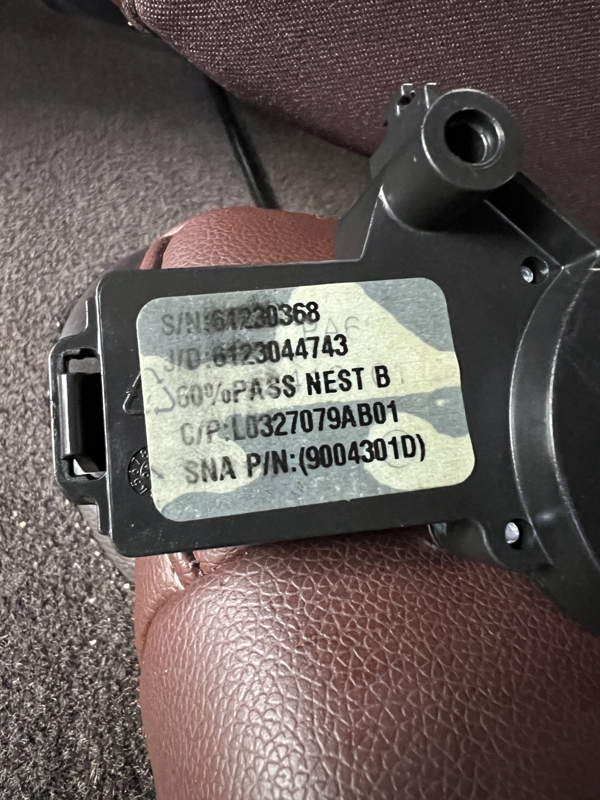

Here is the picture of the actuator. Which one is the part number?
View attachment 451323View attachment 451324View attachment 451325
Suggest posting the last 8 of your VIN and asking @915_Tahoe for the current part number.
You could also take a look at this part, but I don't have an overall view of the part you're looking for or know if it would be for the correct side. Click the link and look at the part, then start that search over with your VIN and see if the part you're looking for is listed.
