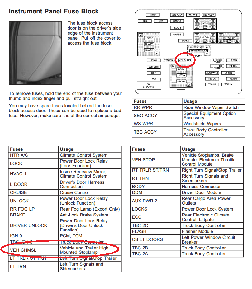

Left & Right work. Replaced the center (3rd) bad one with new...and IT doesn't work either. Ideas?

Do you have 12 volts at the connector for the 3rd light, when you step on the brakes? If not, first check the wiring visible when you have the trunk lid open. IMO, that is where you might find the source of your issue, perhaps a broken wire from the continued opening and closing of the trunk lid.

What year, and have you checked the fuse for the CHMSL?
2005 Yukon XL
I see it on the diagram in the manual. Will look in the daylight.
MORNING UPDATE: YOU GOT IT !!!! It WAS the fuse. Thanx THIS is why I appreciate this site !!

Yes, but, it would blow that fuse once-a-day! The 3rd brake light is on the same circuit as the trailer socket. It was taking too much time & $$$ tracing the wiring from the rear bumper to the fuse box and finding nothing. I ran a wire (and inline fuse) from the 3rd brake light and spliced in to one of the regular brake lights. I never trailer so won't miss the trailer plug.

There's a junction block inside of the right rear quarter panel with the lighting connectors. That gets road splash and has been known to get dirty or go bad. All of the rear exterior lighting goes through that junction block. Easy point to check voltages and continuity.
