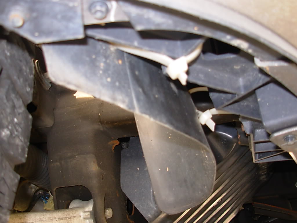

I did not trim any of my fenderwheel plastic...you can trim behind them and then pull the liner back with wire ties.

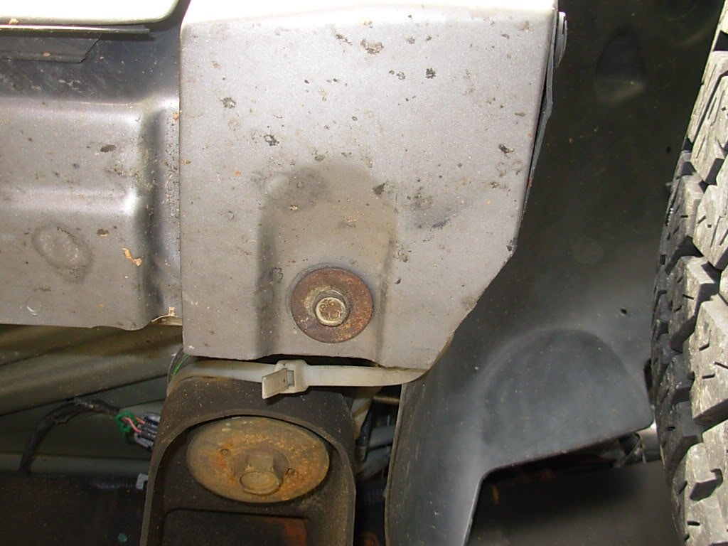

To the backside of the front wheelwell I did trim a corner of the lower rocker panel in the pinch weld area.

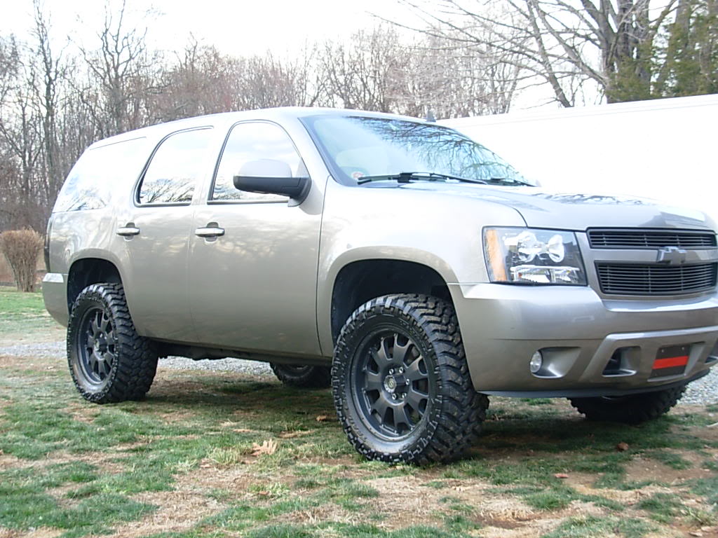

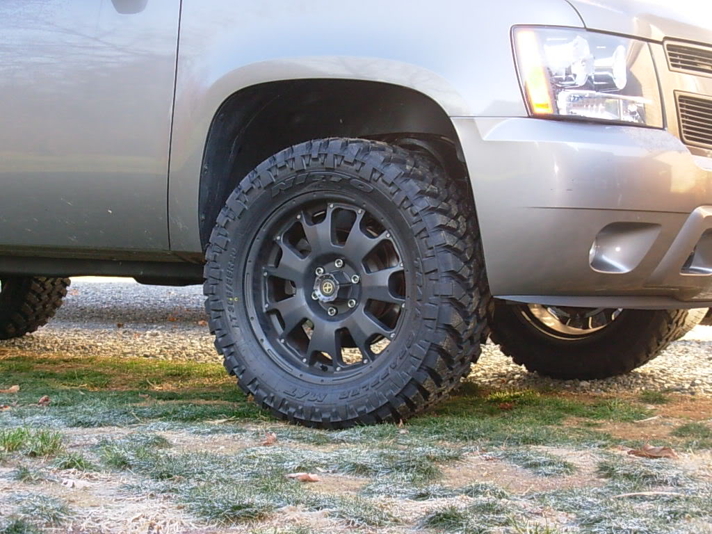

I fit 305/55/20's which are 33" tall/13" wide and I do not rub offroad at all.
Now remember I run a 2.5" CCM spacer up front, for a 2" front spacer I would stick to a 285, 275 wide tire.

Damn those look good. Sorry for being dense, but it is still tough for me to get a perspective; yesterday I was looking at my stock 265 31.7 tires, and notice a half inch at it's closest point (unlifted) to the front fenderwell. I can see where 2 inches of lift will give me maybe 3/4s of an inch before rubbing.
I'm feeling a 32.7 inch 275 mm tire might get away w/o rubbing...
